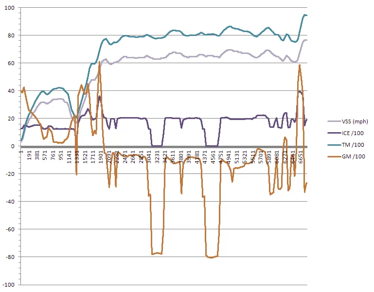

ICE & TM & GM RPM / 100 so it fits on graph with speed.
Got it up to 4000 RPM doing a fast speed increase from 60 to 78 at the end.
Made the Generator Motor come out of opposite spin to lay down that power!
Got up to ICE 150.5 and TM 39.7 ft/lbs tq.
Data file attached if curious.
Ford Maverick Engine RPM at 70 mph for Hybrid 1780634736605-ba

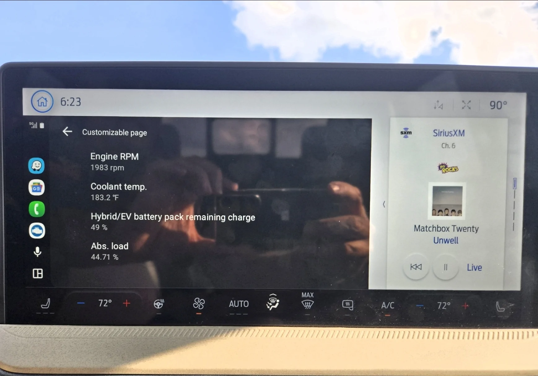

Well said. I have a '25 Hybrid AWD and do all kinds of driving. I have a car scanner Bluetooth OBDII reader and display info on my dash.
If you are towing heavy uphill at 70, you may see close to 5,100rpm. If you are unloaded and on level ground at 70mph usually 2,200rpm.
Compare this to downhill and regen kicks in with no engine or if you are in L driving range the rpm can go way up to more than 4,000rpm as a form of engine compression braking. It's weird to say the least. 😄
When my scanner comes home next week, I'll get you a fresh photo or two if you'd like.

What
what App is that?
my 26 Lariat AWD Hybrid showed ~2300 RPM at 75 mph. It varies depending on load (uphill/downhill).
Scangauge II in my truck.
