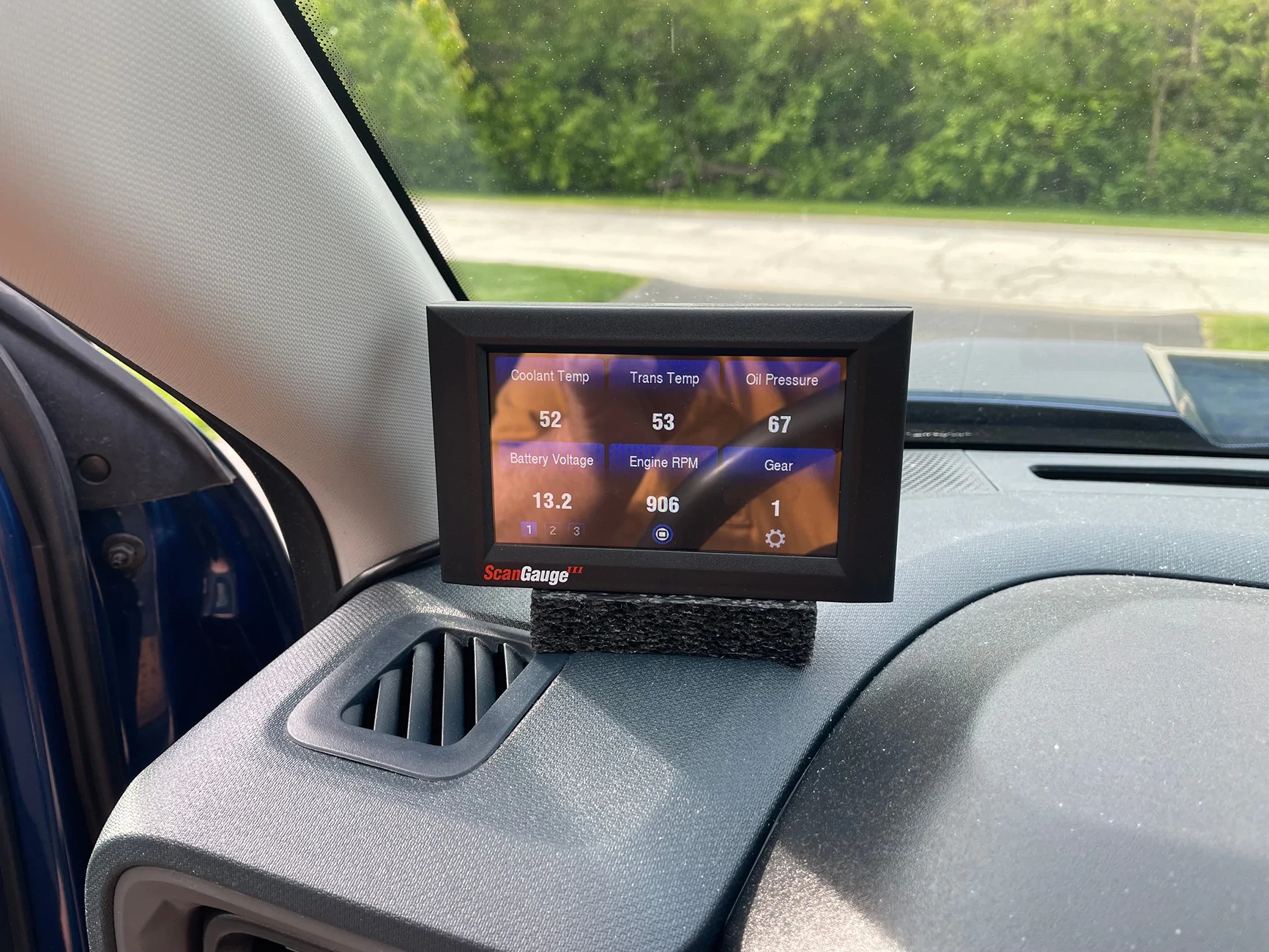

Get a ScanGauge3,,,,,,
HRG
Ford Maverick Engine RPM at 70 mph for Hybrid ScanGauge3
