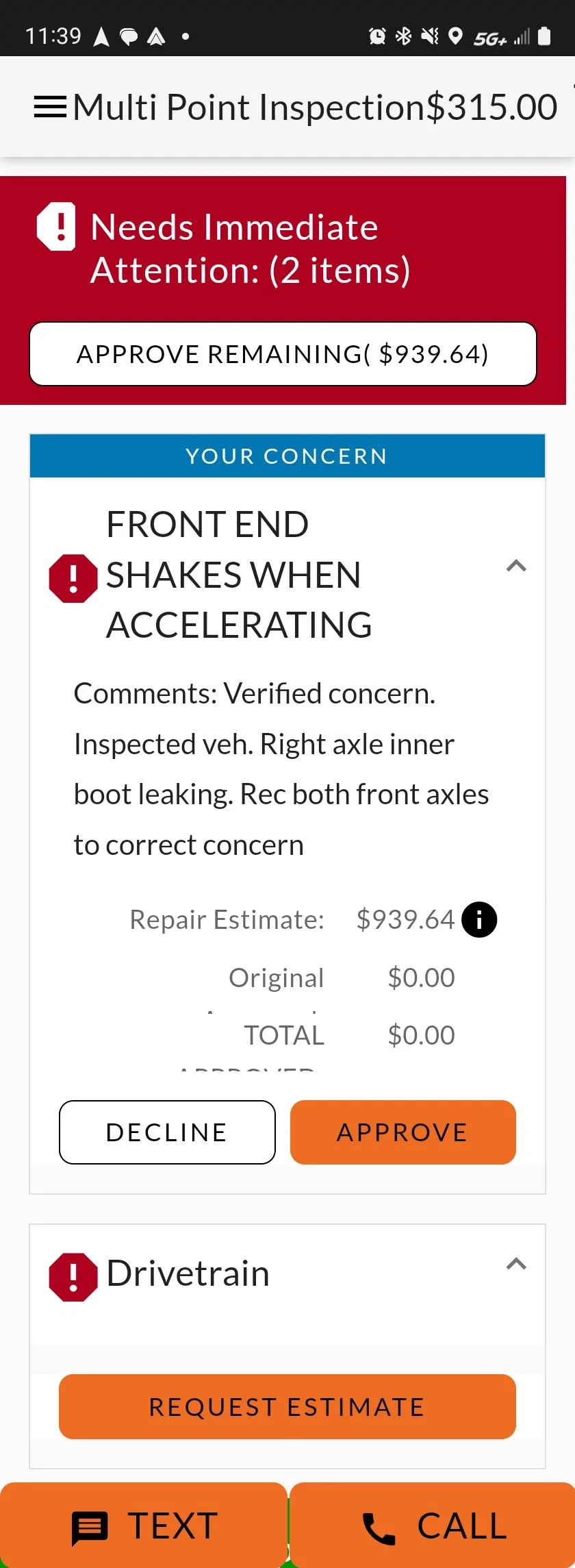

Just got a call from the service writer saying the found one of my cv joints is binding. hmmm we'll see.
Just took my 2022 for same issue and they are replacing both CV axles. We'll see if that's a permanent fix or not.Hello fellow Maverick owner's, this is my first post. My Maverick has started to shake while accelerating if I put it in sport mode or tow/haul mode it's a bit worse going up a slight grade its shakes even at really low speed, say I'm going 50mph and I put my foot into it, the Maverick will shake really bad like if the tires are about to fall off. I just left the dealer with an appointment on the 7th of June for a diagnosis and the air bag recall. I'm desperate and worried they won't be able to fix it. and I've read of other people on this forum are having the same problem, but they don't post after they take it in for repair. ANY help, advise or answers would be great. Thanks, I really appreciate it. I just had it serviced while I made the appointment and the problem was there before and after, so it's not the tires or wheels out of balance.

Hey there, Walter! Can you please send me a DM with your VIN and dealer name/location so I can look into this CV axle part concern for you? To send a direct message, just click on our username and select "Start Conversation". I'd be happy to see what I can do to assist!UPDATE: took the truck in for them to look at the shaking with the acceleration problem. Even before looking at it the service rep. insisted it's likely the transmission. I told him it's been happening to more and more across the country and it's ended up being CV axle problem. He asked if that was an internet thing, I said yes - his response? yeah I don't pay attention to that (in other words, I didn't know what I was talking about). An hour later he calls me, said it was the right CV axle (I did all I could to hold back "I told ya so").
I said shouldn't we do both so as to not create more expense and time later? He said they're not allowed, so only the right one is being replaced. The problem is the axles aren't available (maybe due to it happening more? design flaw?) - backordered. So it's on priority order but no idea when it gets here. He also said there still is no bulletin from Ford to service centers on this problem.
I asked if it's safe to drive, his response: "well should be but then I'm not the one driving it."
Also the recall on the engine catching fore (potentially) is held up because Ford discovered their "fix" didn't work so they are back at the drawing board to figure out how to fix that engine design flaw.
So no idea when my CV axle will get fixed. But the problem was/is indeed the axle.
