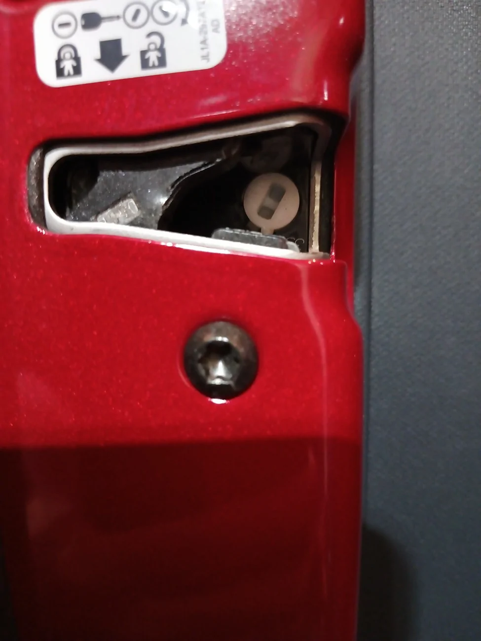

This is on rear doors for child locking unlocking. I'm not sure if it only affects the inside lever or both inside and outside as I have not used it!
Use ignition key or screw driver in the white plastic slot.
See if this is what you want. The 12 mph lock is a safety feature for collision.

That is the child safety lock that only controls the inside door handle of the rear doors. It actually has no interaction with the locking mechanism of the door at all. When that is "locked", it disables the inside door handle therefore requiring parents to open the door from the outside only.
