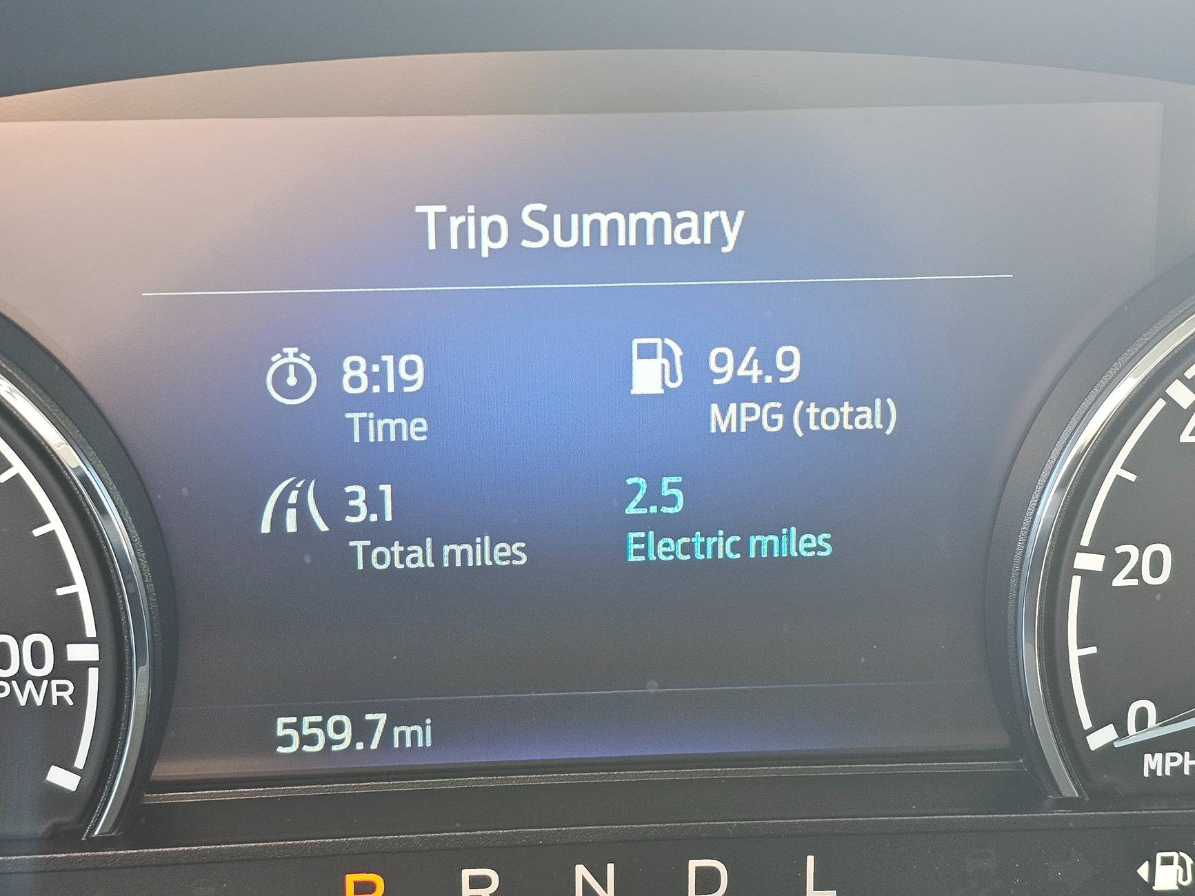

Assuming the engine and outside temps are in the right spot, I found that I can get it into EV mode by lifting off the gas and easing it back down while keeping it below the first tick mark.
I make a regular 26 mile drive since I've owned the truck.
During the summer, I can get 55% of the miles to work in electric and almost 70% in EV on my drive home. It's lower in the morning guessing due to the cold start.
In the fall/winter it drops a lot - about 35% and 45% respectively. The difference between the morning and evening I feel is that the engine cools off while I'm in EV mode to the point where it starts up to get to operating temperatures again.
On the highway/turnpike, it rarely gets into EV mode - which is why I drive my 6th gen Camaro or C8 Corvette since they can both get about 28+ mpg on the highway and are a lot more fun to drive LOL
