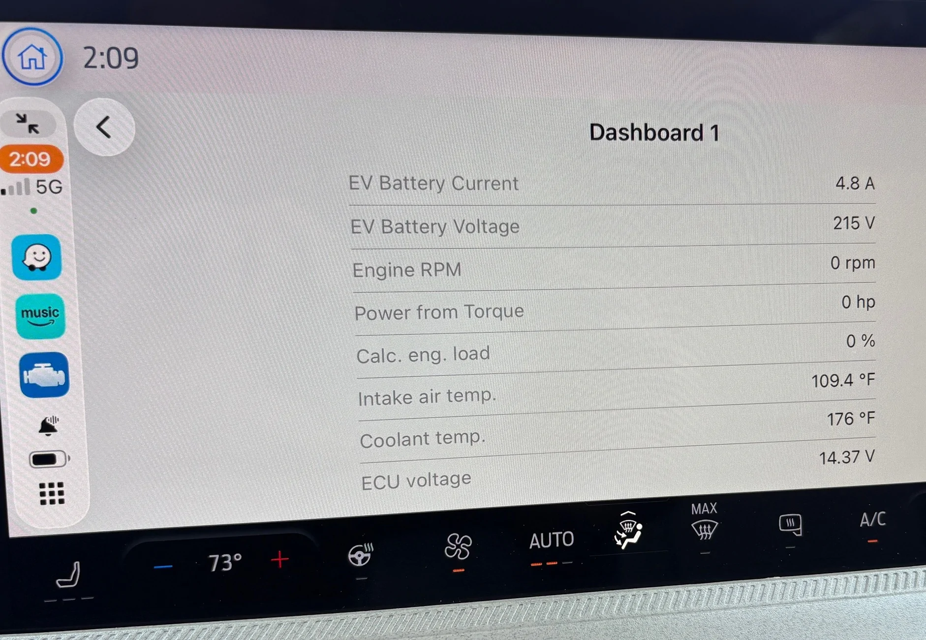

Here’s what I have observed looking at live OBD2 data… Switching between EV and GAS on our 25 Lariat AWD hybrid, the computer control looks at three parameters (and maybe more). Battery Charge Level, EV motor amps draw, and actual gas engine load (% torque).
Percentages below are approximate.
EV only mode is used if battery charge level >32% and electric amps drawn are below 90 amps. Once you exceed 90 amps draw the gas engine starts OR if batt level drops below 33%+-.
Once running, the gas engine mode may provide a low-ish charge to the ev battery while running, or the ev motor may pull amps to supplement the gas engine on increased load. Computer controlled but seems to be smart about it.
when in engine mode the truck will go back to EV when the actual engine torque is below 33%+— AND there’s at least 35%+- charge on the battery.
The EV coach graphic seems to mirror this with the moving bars, but doesn’t really show when the gas engine is adding some charge back or getting supplemented by the electric motor.
I use L mode to maximize regen (provides a perfect score on the brake coach), but need to be careful as there’s no automatic brake light that you get with ev one pedal modes.
(the pic doesn't show it but I've added actual gas engine torque parameter to the displayed data list)
I'll note that it takes a very light foot to get going and not pull more than 90 amps from a dead stop.
Depending on the terrain, wind, etc you MIGHT cruise at 50+ mph and still have an actual gas engine load below 33% - so it will switch to EV for the cruise until the battery drops below 33%
33 seems to be the magic number.
Makes sense that Ford won't let you deplete the battery since it uses the EV motor for reverse (there's no reverse gear in the ECVT).
I've not yet seen my battery charge get above 70%, but I've not done any long trips with the monitor on. Most of the time I come home with about 40% charge and see it roll around 30-60% during a drive.
