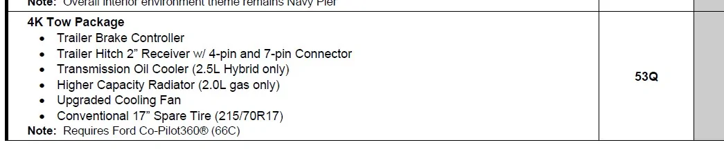

Per the order guide, there is no transmission cooler added with the 4K tow package on a 2.0EB
HRG
Ford Maverick Is 4k Towing Package Worth It Screenshot 2026-06-11 213821

interesting! Did that change from previous model years? Or does the EB already have an air-to-oil cooler?

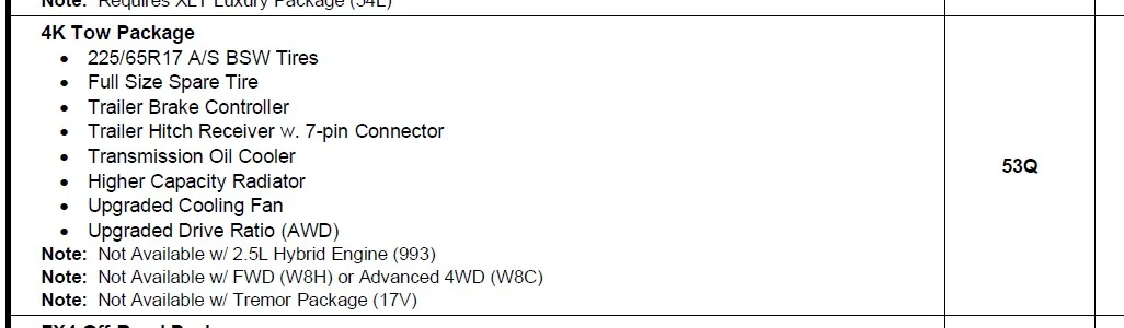

Here is from the 2025 Order guide
Ford Maverick Is 4k Towing Package Worth It Screenshot 2026-06-12 013910

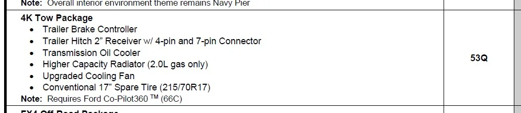

and the 2024 Order guide
Ford Maverick Is 4k Towing Package Worth It Screenshot 2026-06-12 014142

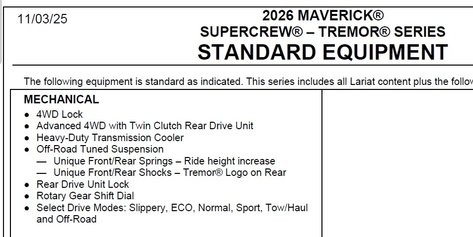

I find no other mention of a transmission cooler as standard equipment on XL or XLT models. Only the 2.0EB-equipped Tremor lists a transmission cooler as standard equipment.
Ford Maverick Is 4k Towing Package Worth It Screenshot 2026-06-12 015120

Hmmm..so on the Ecoboost XLT the 4k towing doesn't have much better cooling under normal driving conditions?

It would offer better engine cooling, just nothing additional for the transmission. For the roughly $700 (Employee pricing) I'd get it.

Weird how ford de-contents things over the years. This is the 4K tow on my MY22 from the order guide
4K Tow Package (NA w/ 2.5L Hybrid Engine (993)) (NA w/ FWD (W8E))
• 225/65R17 A/S BSW Tires
• Trailer Brake Controller
• Trailer Hitch Receiver w. 7-pin Connector
• Transmission Oil Cooler
• Higher Capacity Radiator
• Upgraded Cooling Fan
• Upgraded Drive Ratio (AWD)

I'm glad they updated "full size spare" to "conventional spare" to be less misleading. A lot of disappointment when everyone found out that the "full size spare" doesn't match the diameter of the road wheels.

Thanks for the information. So it seems that for 2026, the EB no longer gets an auxiliary transmission oil cooler with the 4k tow package, but the hybrid does get one.
