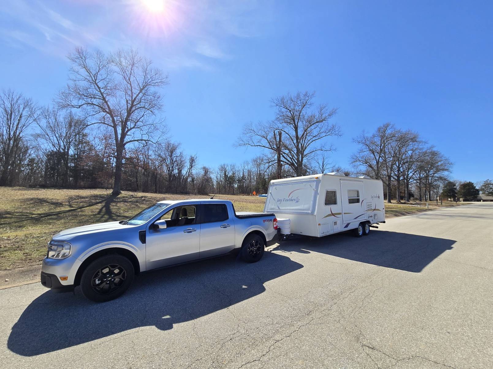

I've towed a few times now with the Maverick and I'm getting concerned with the looseness of the hitch in the receiver. I've tried 3 different ball hitches in the receiver but each have a little play witch causes honorable banging noises each time you brake or accelerate. It became very pronounced when i tried pulling my Jay feather 23B 3800lb camper for the first time this weekend. I don't know if I should try and find some metal shims to remove the little play in the receiver or that's just how it is. I still have to try the weight distributing hitch still for the camper but I have to readjust the height of the ball on the hitch from when I had it on my old f350. Just want to see if anyone else has this problem.
