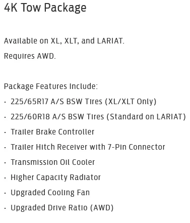

What does the 4k towing package include?

It's a 5% change, so you will get 5% more torque and 5% higher revs. What 5% higher revs means I can't tell you, I assume the window sticker shows the new mpg?

Even if you don't plan on towing more than 2k the added cooling capacity and transmission cooler are worth it for longevity of the engine and transmission.
And I say don't underestimate the value of those coolers. The only vehicle transmissions I ever had go bad were ones that didn't have a cooler. Every other ones that had a cooler were still going strong when I got rid of the vehicles.

I was thinking more along the lines of buying the tremor for the different bumpers etc, and then equipping the parts from the 4k...But it's more than just springs and a trans cooler. I will stick to the original plan of 4k/FX4. THanks for the responses.

A lot of people seem to ask in hindsight if they can equip a non 4k tow Maverick with the required equipment aftermarket and my suggestion is if you intend to tow more than 2k pounds just pony up for the relatively cheap package. Even if you don't plan on towing more than 2k the added cooling capacity and transmission cooler are worth it for longevity of the engine and transmission.
Couldn't agree more. That's why I added the tow package to my order. A bit surprised that it doesn't also feature an upgraded alternator. Evidently Ford didn't see this to make much difference
and resale value.
This is why I choose this option even if , today , I do not plan on towing anything.
In addtion how much will this package would cost you to buy and install afterward?
