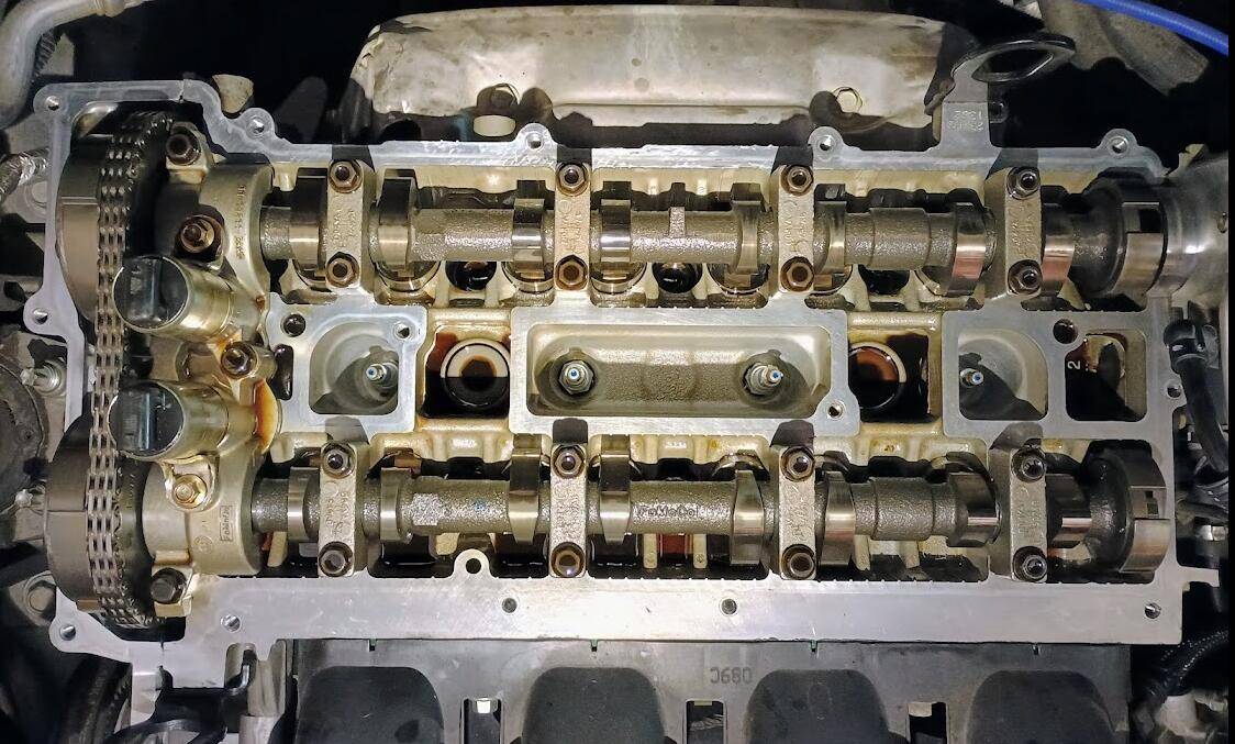

I wouldn't necessarily expect it to ever need cleaning. I have a 2012 Focus with direct-injected Duratec 20, which is the Mazda/Ford engine the Ecoboost 2.0 design was based upon. It has 150,000 miles on it, runs like it did when it was new, and has not lost any fuel efficiency. It has always been fed Top Tier fuels (Phillips 66 mostly) and synthetic or synthetic blend oils at 8,000 mile intervals. I also run a bottle of PAO-based fuel cleaner before every oil change (Chevron Techron concentrate).
It doesn't consume oil, and has remained very clean. To illustrate, this is what it looked like under the cam cover when I replaced the gasket a few weeks ago. Clearly there is not much of anything nasty accumulating from blow-by in the crankcase to get fed back through the PCV:
Ford Maverick Intake valve cleaning 1749050211785-xs
Keeping in mind that boosted engines are harder on oils than N/A engines, I recommend Top Tier fuel and 5,000 mile synthetic oil change intervals on the 2.0 Ecoboost. If someday it shows signs of intake valve deposits (rough idle and/or reduced efficiency and/or loss of power), do a walnut blasting. Until then, just keep feeding it the good stuff.
