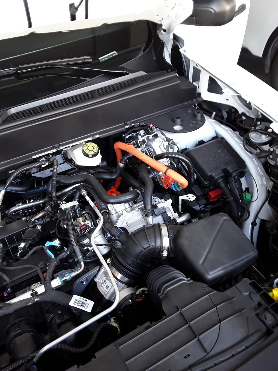

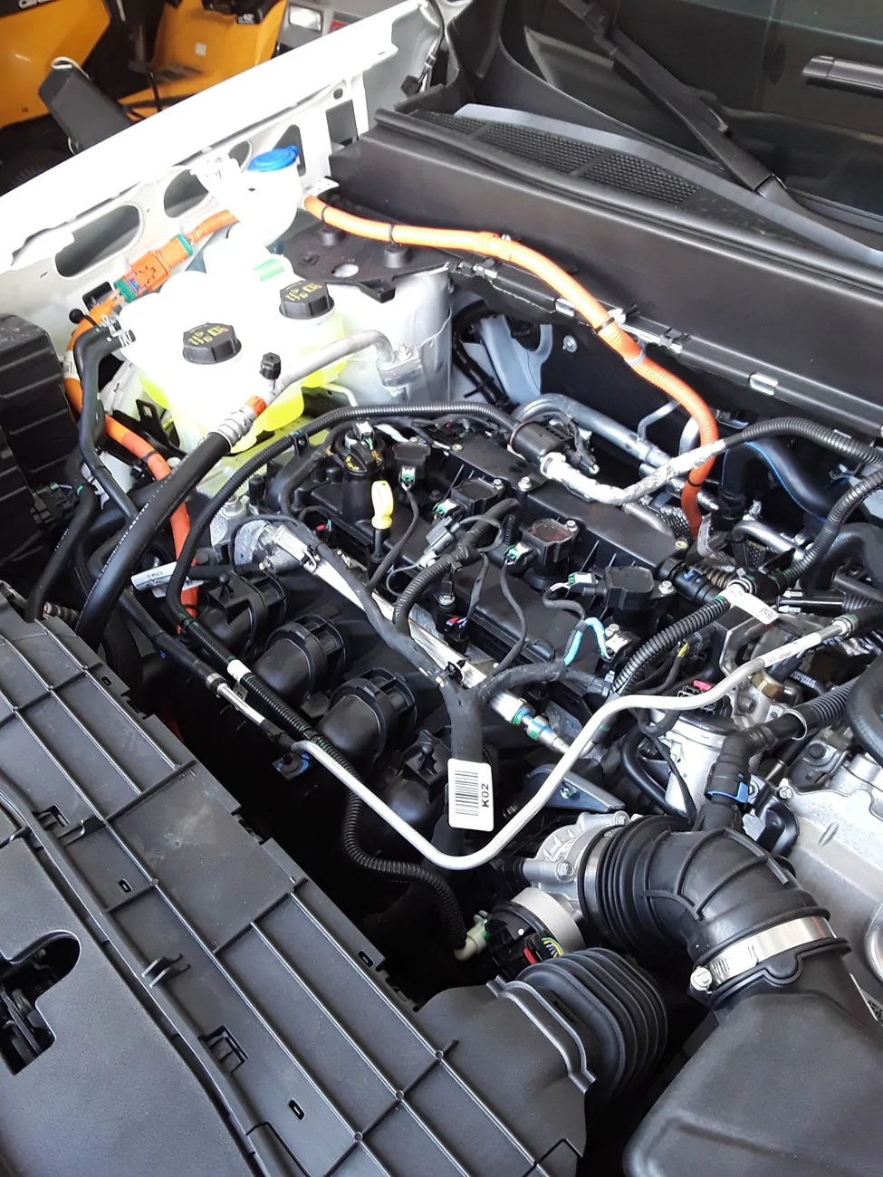

Picture of my 2026 Hybrid XLT ... looks different than SafetyGuy's picture.

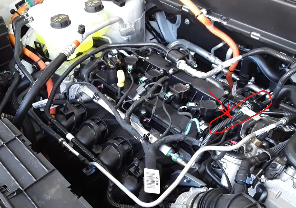

Ret,

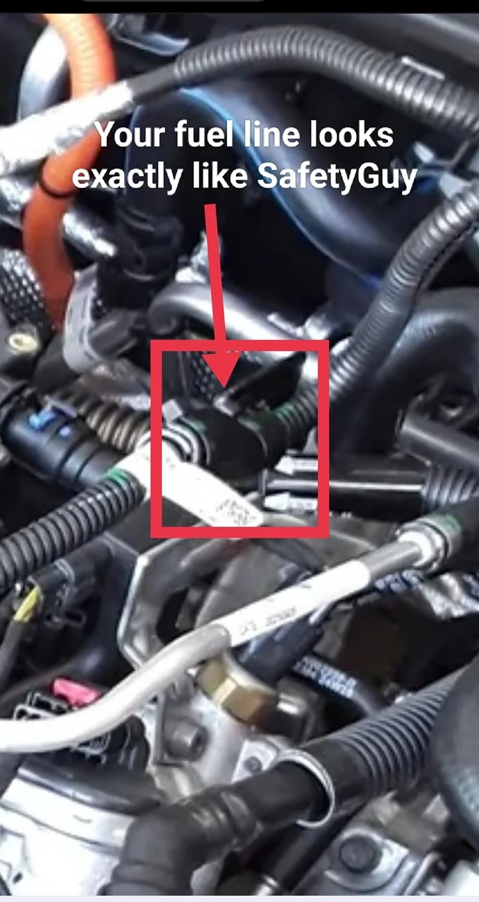

Your fuel looks like @SafetyGuy
In your picture. I isolated the area and highlighted where the fuel line has been changed. I can see the Zip ties.

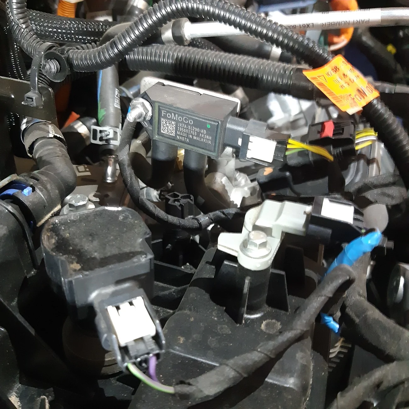

Hey Glen Baker ... you're absolutely correct ... I looked closer, and took another picture (attached), and mine is exactly the same as SafetyGuys ... Thanks !

Mine is the same as the other MY25's not a big surprise.

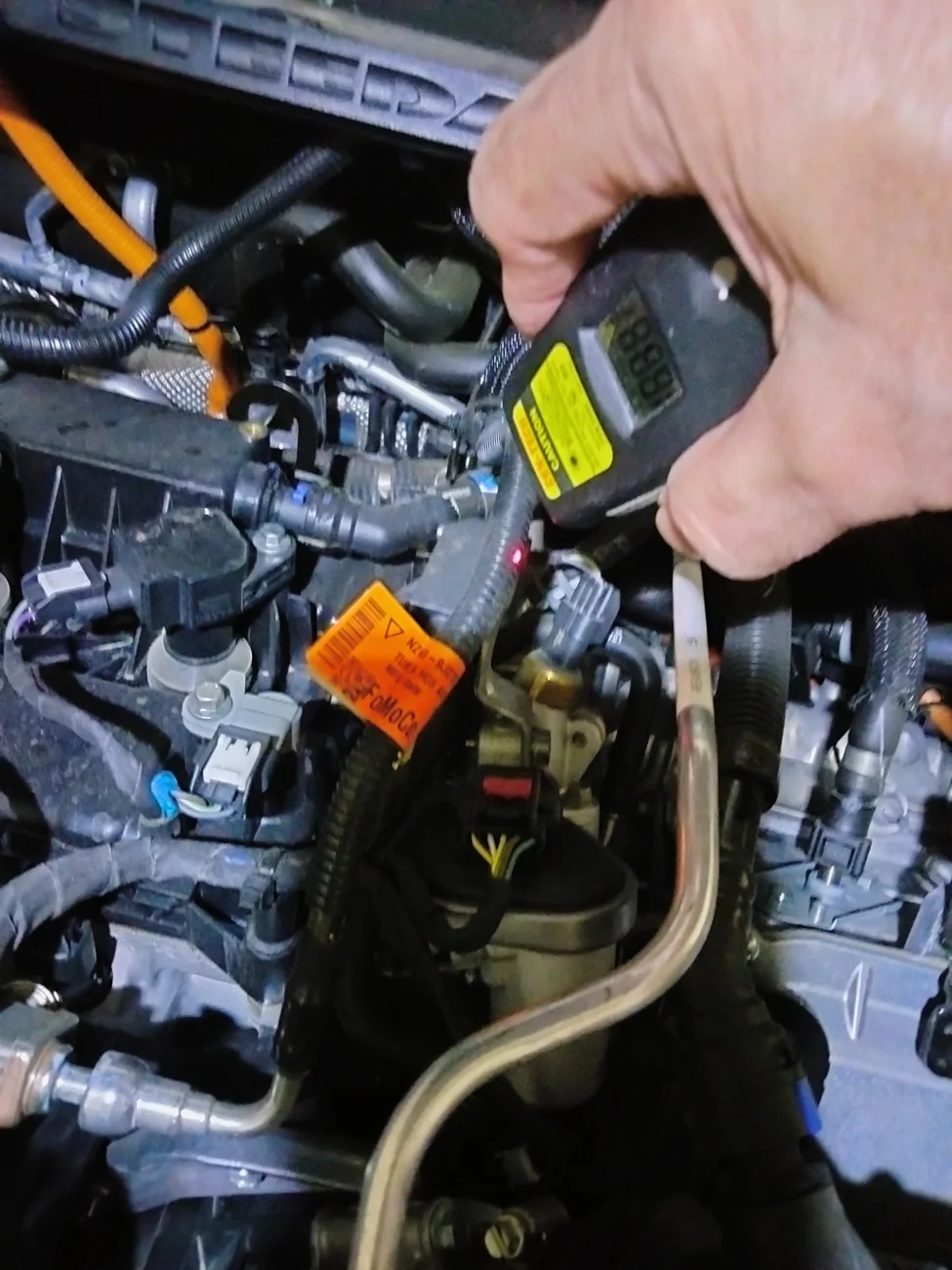

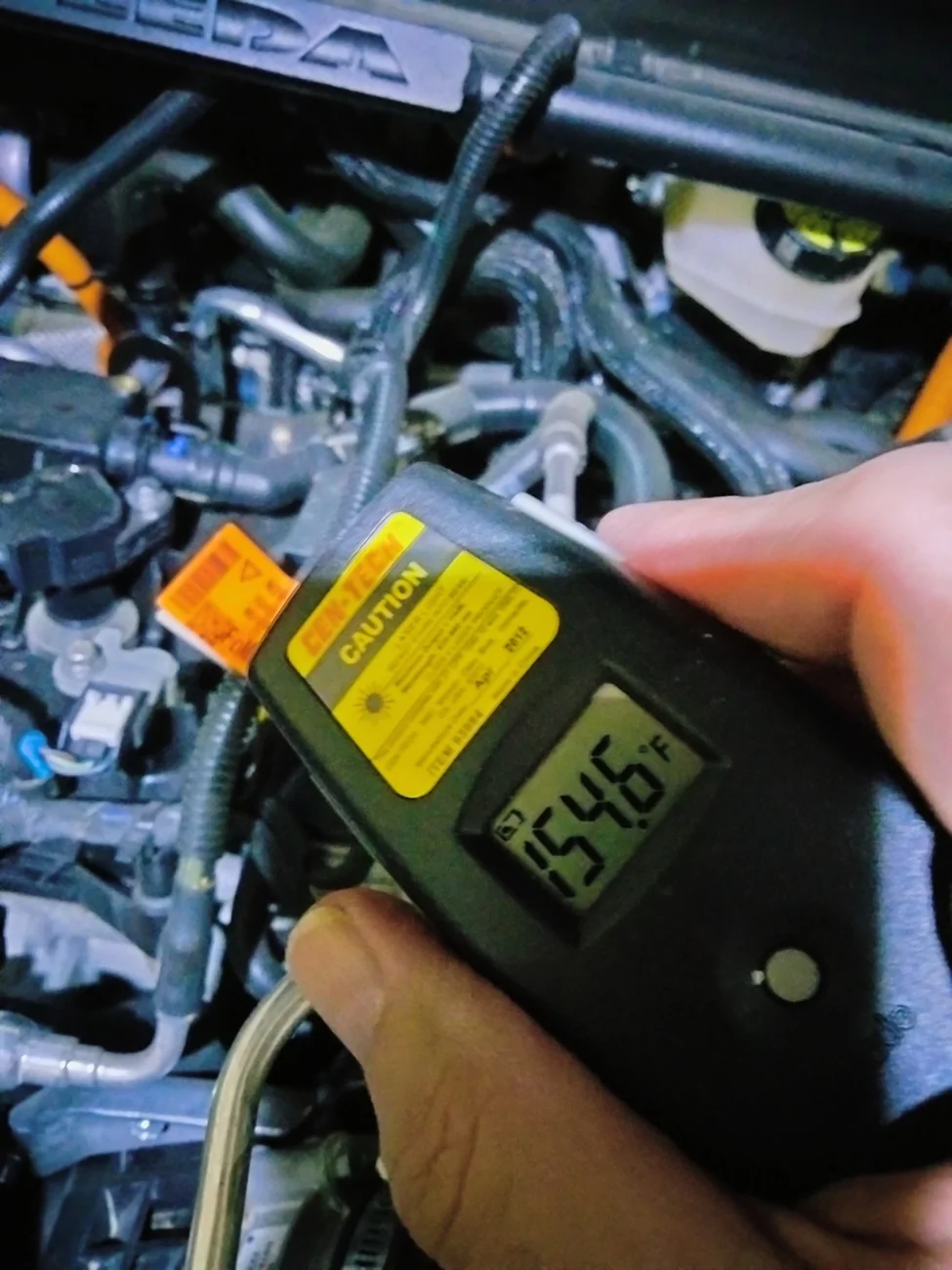

On Sunday when we got back from running errands. I was curious so I took some temperature readings around the area. I also felt around with my hand and there was nothing that was hot enough to melt plastic or burn through the fuel line.

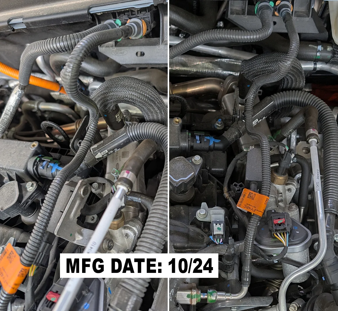

Here's the fuel line in my Maverick, which was built in October of 2024 so probably near the very end of the 2024 production run.

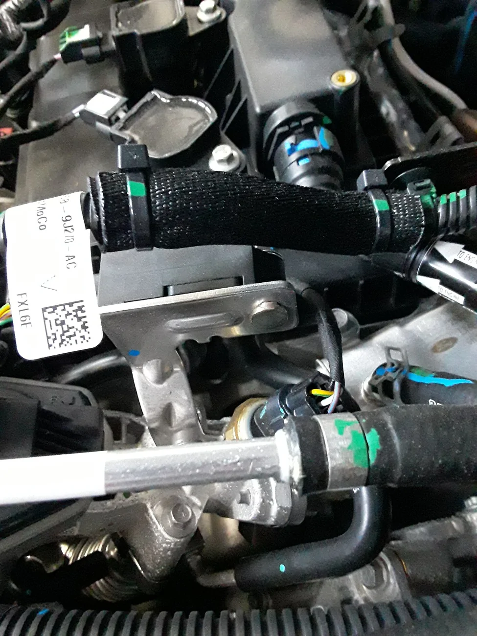

On Sunday when I took the temperature pictures post #54 that bracket was only coming up with a temperature of about a 162° it was so far away. I didn't think it would touch the fuel line at any point
At least on my Maverick it would not.

Great picture showing the gap.
What's the step above an Italian tuneup?
I mean if it was movement - there's that hose right below the bracket holding the fuel line.
That's much closer if the engine was torquing itself up that high.
Oh - it has extra protection on it...
Also notice - your fuel line is zip tied to that bracket.
The 25/26 pics show the new fuel line with a plastic connector actually plugged into that bracket - so lower overall.
Hmmm - MattTX has his 24MY plugged in too directly to bracket, riding lower.
You had any work done on yours in that area?
The bracket plug is there.
