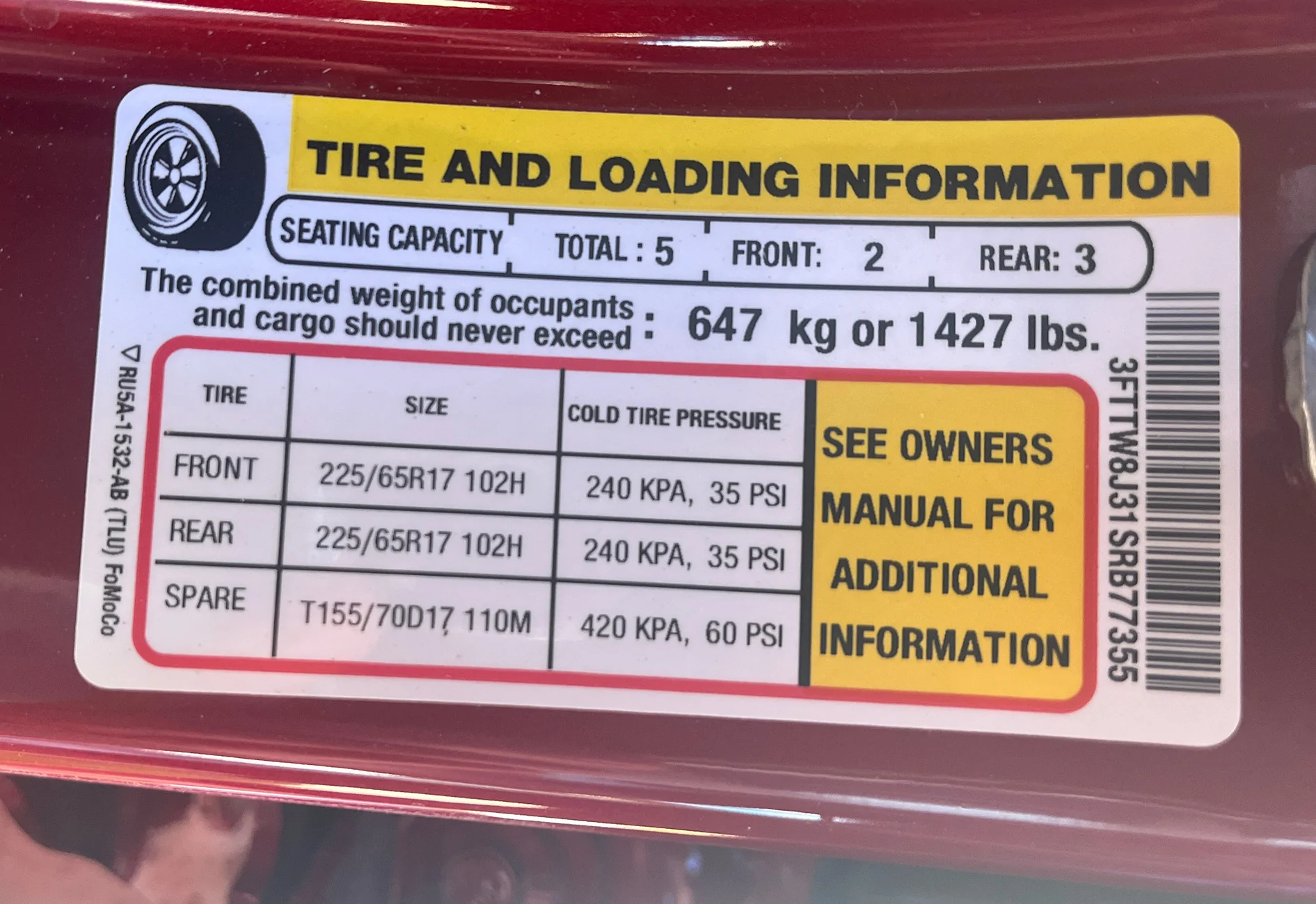

Mine shows 1499 lbs combined limit this depends on options but that Lobo one seems crazy low. Do the factory lowering springs reduce the payload on it?
2022 XL with the options shown
I paid $21,846 which was 4% below invoice price plus the dealer fee of $394(Chapman if anyone remembers) and paid $200 to the receiving dealer in Arizona instead of shipping it to the purchase dealer in PA.

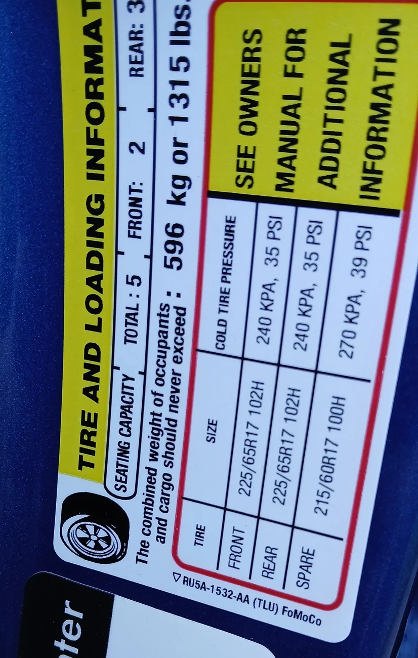

Mine is rated at 1315 lbs, maybe because it's the FX4? Offroad suspension little softer maybe? I have no idea myself but interesting how the load ratings vary 🤔

FX4, 4K towing and AWD lead to a drop over FWD, due to the weight of the extra cooling radiator, RDU, PTU and drive shaft. If you have a rear sliding window and sunroof you’d take a hit for those too.
Do you have the luxury package? I have a '24 FX4 with 4K as the only options, and mine is 1378. Somehow you have more options that total to 63lbs. Moonroof or rear sliding glass maybe?
The FX4 suspension is not softer than standard AWD. The only difference is that it has monotube rear shocks. There is also no difference in suspension between 2K and 4K tow ratings.
Interesting 🤔 No luxury package. I do have the "full size" spare although it's a 215 not a 225. Also the dealer installed a Leer low profile fiberglass cap but can't imagine the manufacture had any idea that was getting added at the time of build 🤷‍♂️ and I would think even being fiberglass that's about 100-150 lbs extra?
