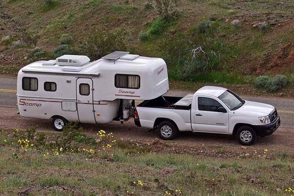

Has anyone tried a 5th wheel like the Scamp yet? 2700lbs, 3500 loaded.
