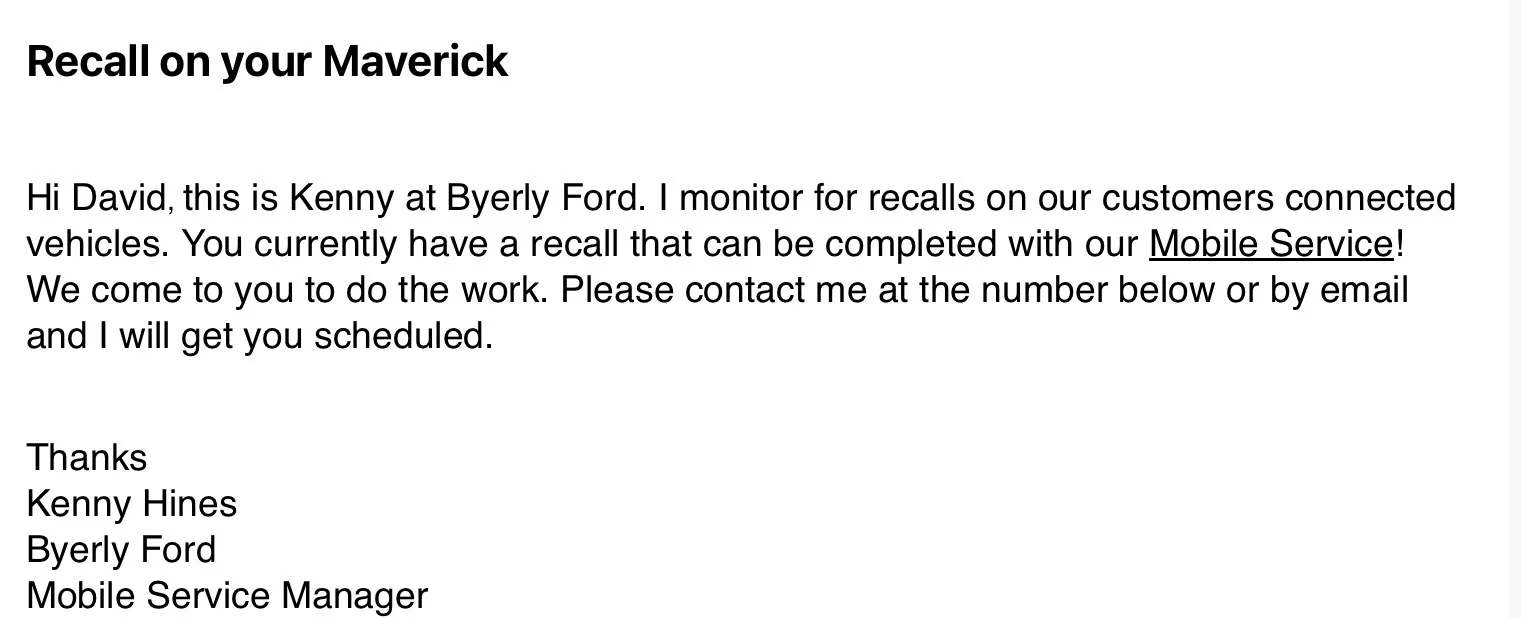

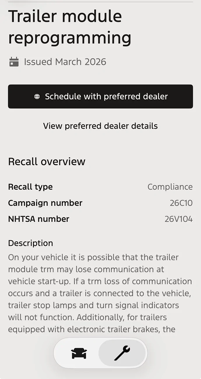

First Recall - Trailer Module- Anyone Else?
Moombaky
Mar 11, 2026
2026 Ford Maverick Lariat AWD Hybrid
Ford Maverick First Recall - Trailer Module- Anyone Else? IMG_4457
Ford Maverick First Recall - Trailer Module- Anyone Else? IMG_0361

See links at bottom of this thread. Yes I got it, no fix at this time.
I received the recall notice. Fix WAS completed at dealership in April. Don't understand "no fix yet"? I would expect all dealerships to be able to do it at same time? Perhaps not. Bottom line, fix is available. My dealer did that one and the park brake recall same day, one trip.
Packer Bill
Jun 21, 2021
1,928
2,593
South Dakota
The fix is available for 25-26 models. No fix is available for the 22-24 models.

Good day
I just had my Mav in the shop yesterday for the Trailer Module update to be carried out, along with a couple other things (like the rear passenger door window trims pulling apart at the joint, upper rear corners).
Funny thing is, I have a change to my trucks 12 volt charging level when it is running. It was noticed immediately when I started it up to leave my dealer's lot.
I have an inexpensive volt meter in the dash 12 volt power port which I know indicates 0.1 volts high.
Since March my 12 volt charge levels when driving were varying between 15.1-15.2 volts (corrected from displayed value). (Over 15 volts is not good for an AGM battery).
(I do regularly recharge the battery with an appropriate AGM 1-7 amp Canadian Tire charger).
As soon as we started up the truck, I noted that it was charging/system voltage was at 14.59 actual! By the time we got home 20 kms later it was indicating 14.19 volts (actual).
(I metered the battety-boost points under the hood after the truck had shut everything down 2 hrs later and it read 12.8 volts....12.8-13.0 volts is considered fully charged).
I started it twice since and same ballpark voltage readings.
I was working around and in and out of the truck yesterday (this would slowly draw down the 12 volt battery, waking the truck up repeatedly).
I just got a call from my wife who is out and about (and knows about my 12 volt system...ahem...interest) to let me know that the truck was charging the battery at 15.1 indicated volts (15.0 volts actual).
She knows that over 15 volts is bad, and now knows the indicator reads 0.1 volts high, and called to let me know. She is a keeper, alright!
This is great, as that is the maximum normal charge voltage for an AGM battery.
I just don't know why the values changed as this module has never come up as being associated with the charging levels (or lack thereof) for our trucks.
The only work that was done (having to do with electrical or modules) was the Trailer Module Reprogramming, recall # 26C10B.
Has anyone else noticed a similar change/improvement in their Hybrid 12 volt charge profile after the Trailer Module reprogramming?
