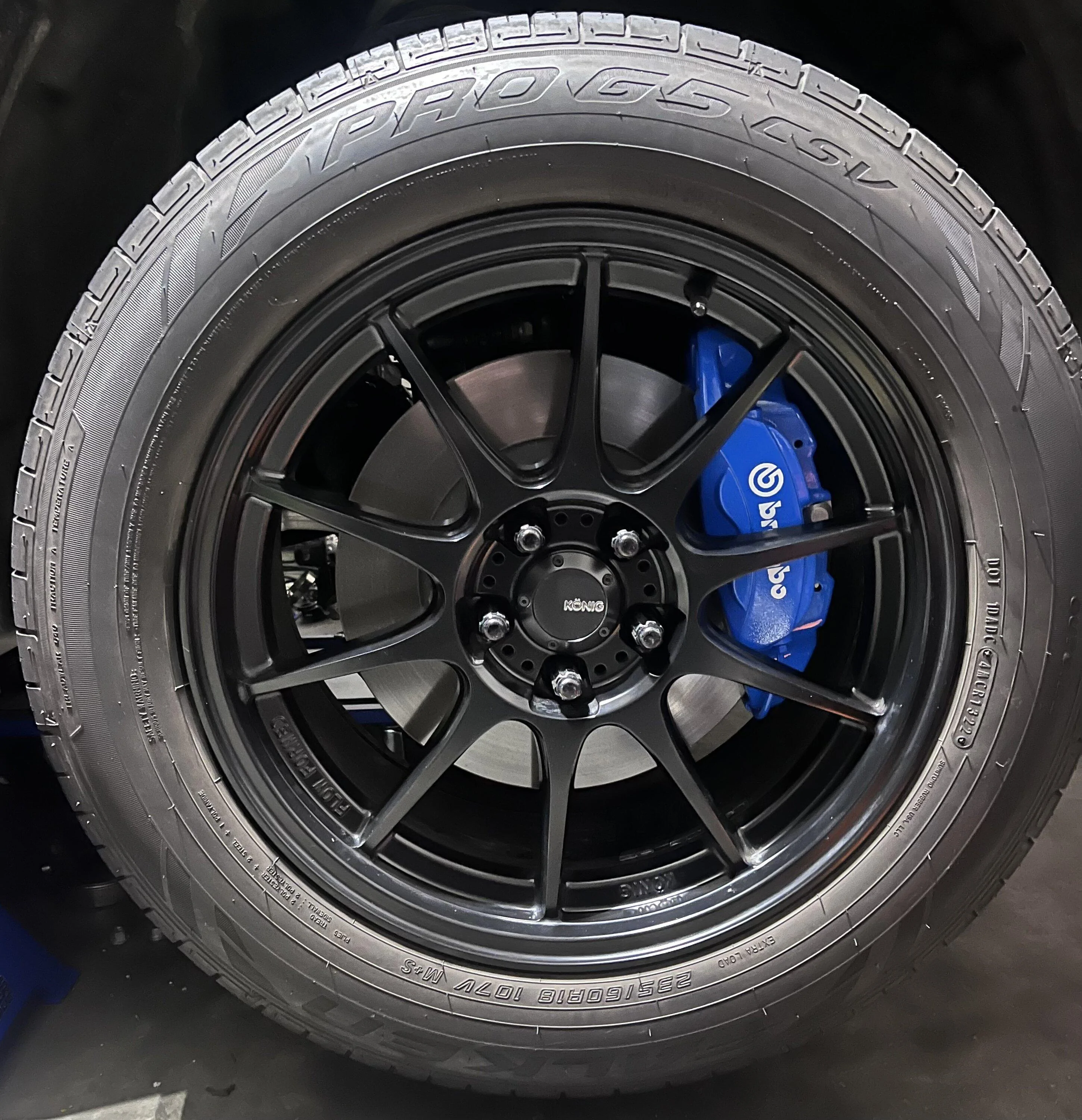

The credit goes to Lawrence Giles as he told me about this a while ago. He’s been working on a front kit and should hopefully have the adapters ready soon. This is just dry fit with the Mav rotor. Wheels are 18x8.5 43 offset and per Americas Tires website these wheels fit a 16 RS. I bought a set a focus and maverick brake lines and will have some hybrid SS brake lines made. Rotors pads and hardware aren’t too expensive so it’s really just the caliper bracket.
