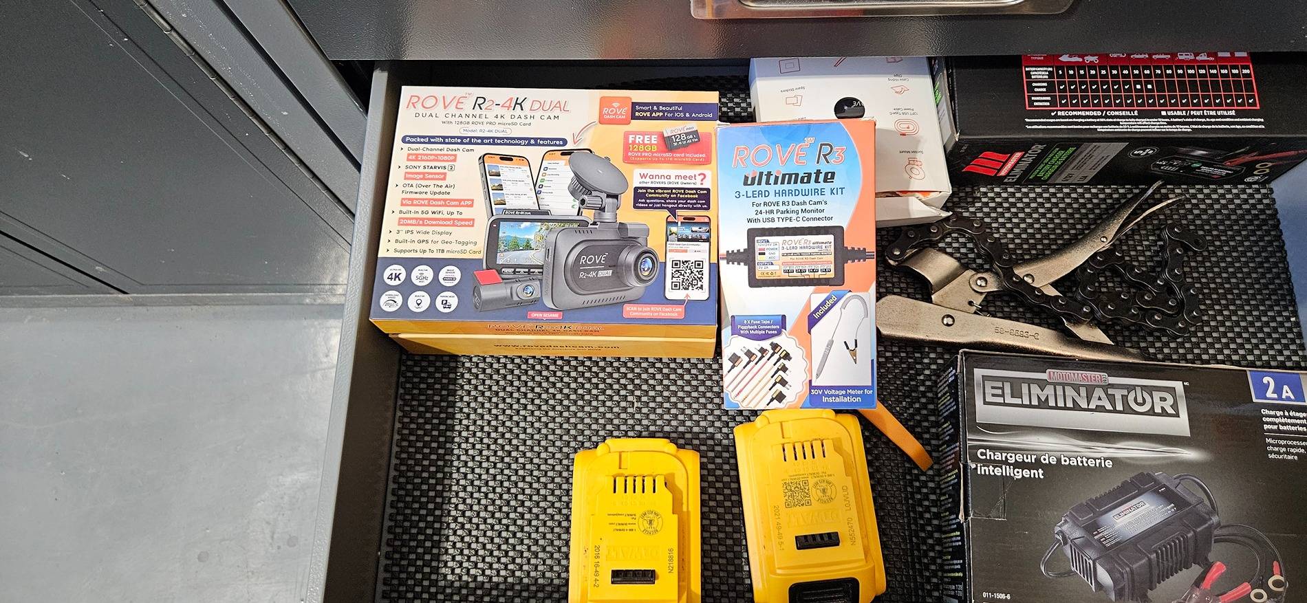

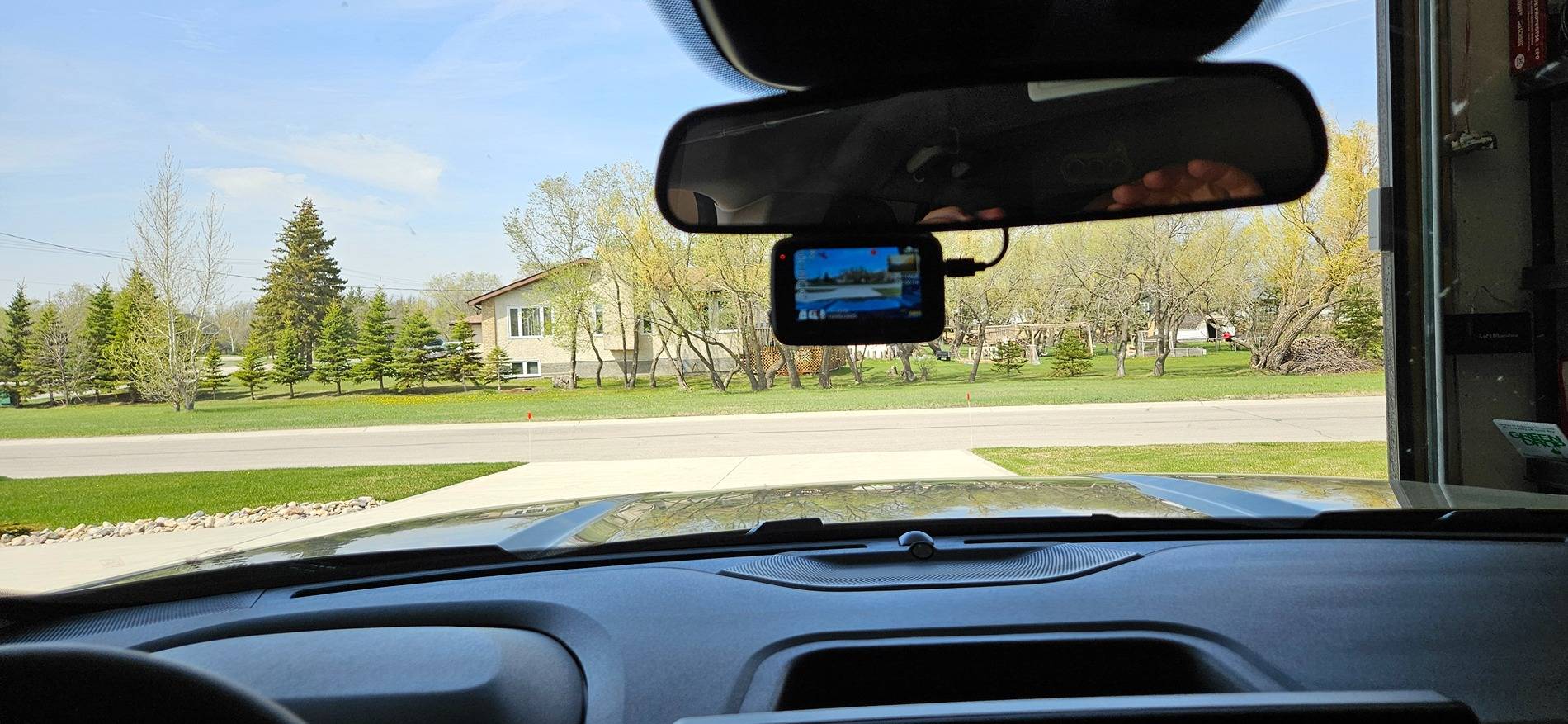

I have read and seen positive reviews of Vantrue cams, but we have a camper van that we bought a ROVE PRO (front cam only) a few years ago and really liked it. So I just bought and installed a Rove Dual cam...front and back in our Maverick.
Vantrue has a wider field of vision, but I only wanted one app on my phone. Rove comes with it's own memory card, has a capacitor, 4k, etc and I like how they work.
Vantrue cams have a smaller profile when positioning behind your mirror.
I am not pushing Rove cameras, just sharing that I have been very happy with mine. I would not have bought a 2nd otherwise!

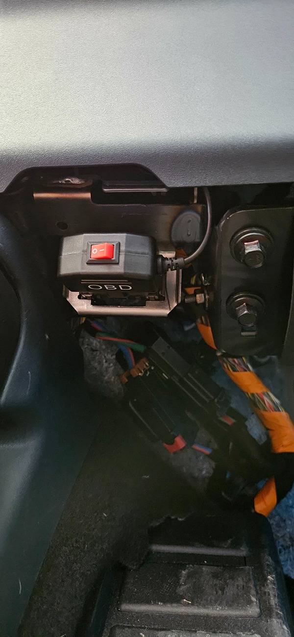

Also look at how you want to power it. I bought 2 OBD plugs to power ours. Switch one way and it turns off after a bit...flick the OBD plug switch to the other selection and it stays on forever...good for in parking lots or parkades. I use the first option.
You can hardwire it in to a appropriate fuse location...videos are out there how to do this but not my choice...this way works for me and it is inexpensive.
If you get a single or dual cam, search for install videos that show how to route the cables so they don't interfere with your pillar air bags. I found one on my third try, good to know. Forewarned is forearmed.
Before you begin, if you don't have panel removal tools yet, you will need them to do a damage free install. Both my ROVE cameras came with a very basic panel tool but they do work for the task demanded of them. I have an assortment of them but just used theirs.
Cheers and good hunting!
