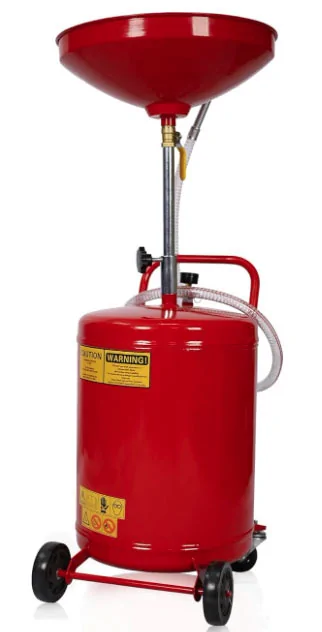

I question if a tech at a dealer would KNOW if if anything was under filled. Why I say this. As a former one we didn't drain into like a catch can that you could later measure to see how MUCH fluid came out. Why would we ever bother.
One of these is what we had . so no idea if anything was ever low.
Absolutely correct. NO shop confirms drained fluids, ever.
I'm coming up on my third (60K) RDU/PTU D&R. With only a half quart capacity, sooner is better. 🤠
