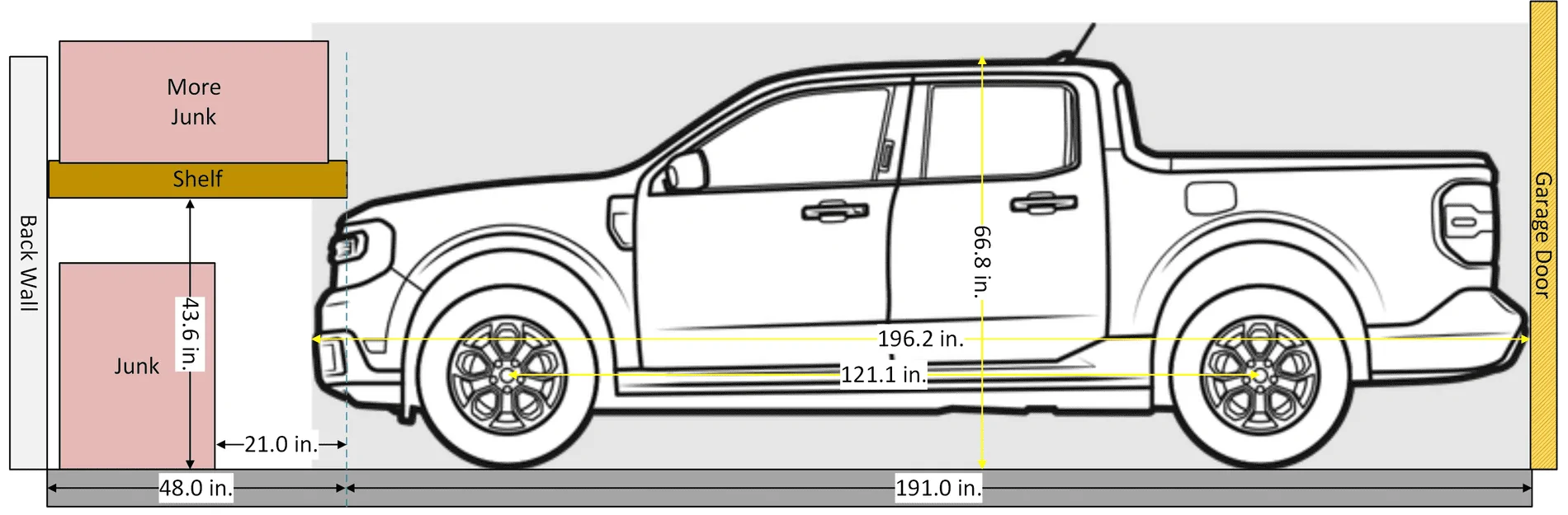

Does anyone have a confirmed dimensional drawing of the Maverick?
I am trying to determine if the Maverick indeed fits in my garage. It has to fit, as condo rules require all cars in garages except for visitors. Also, there is a large shelf at the back of the garage. The shelf could be moved, but I would prefer moving it before I take delivery. But I don't want to move it if I don't have to!.
Dimensions, per Ford
Wheelbase 121.1 - This is easy, center to center of course
Vehicle length 199.7 - Does this include the bumper? I think so
Vehicle height - maximum 68.7 - Does this include the antenna? It seems no.

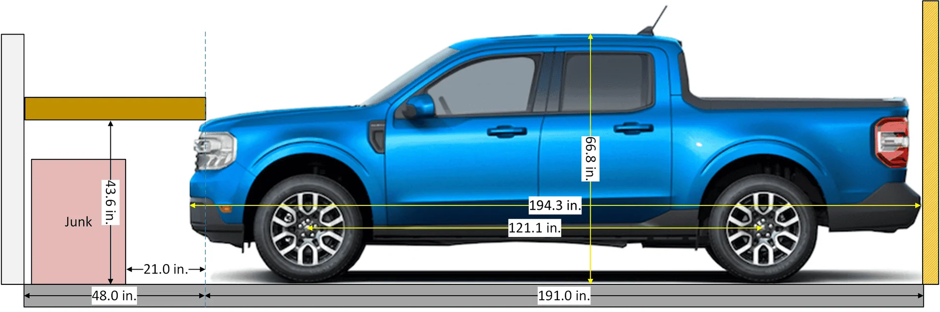

Based on what I could find of various pictures and drawings, the above dimensions are incorrect.
When I scale the length to 200", the wheelbase looks to be 125"
When I scale the wheelbase to 121", the height is 66.75", and the length is 194.25"
Picture attached is one try, I have checked other pictures.
Thanks!
