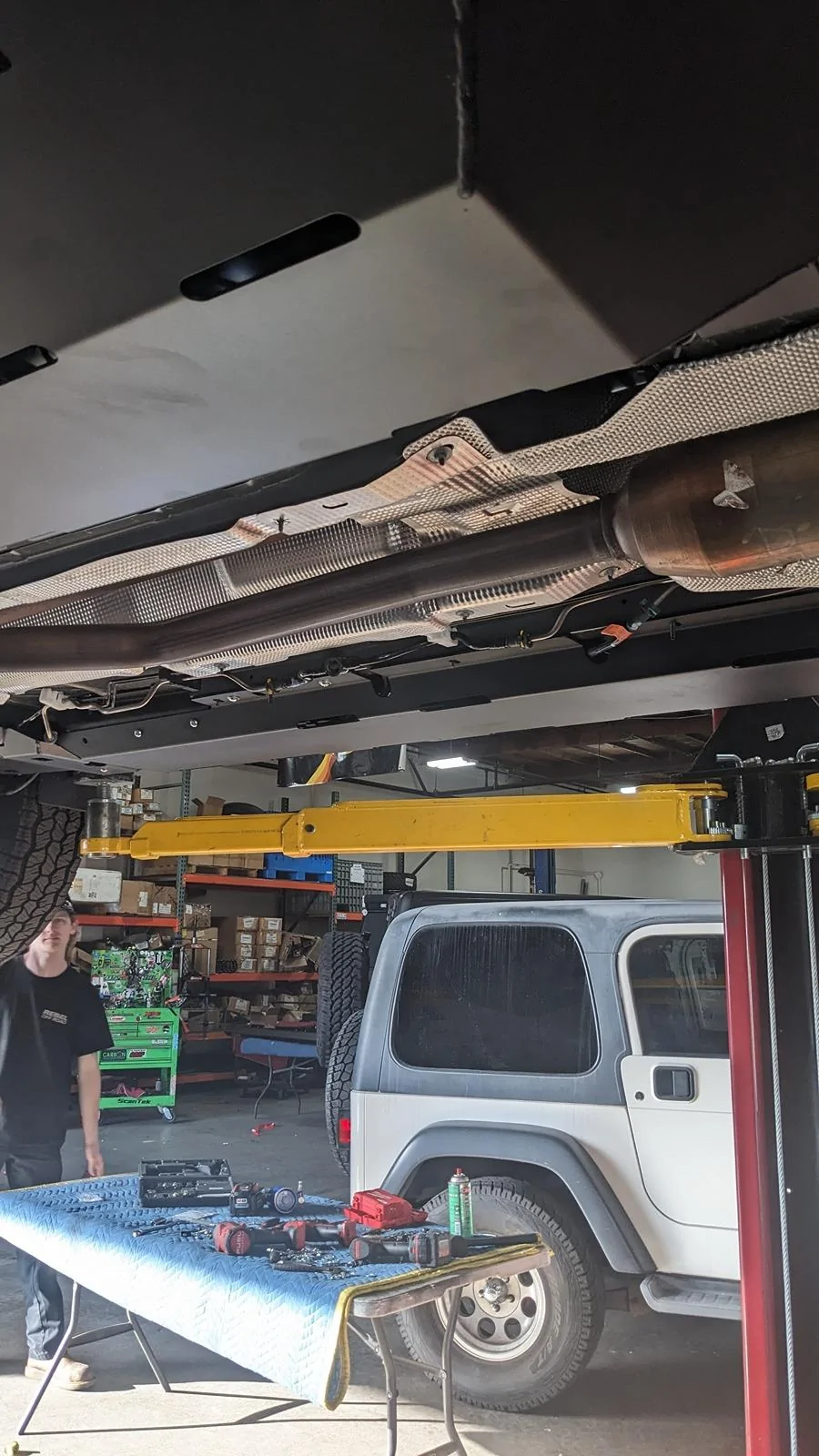

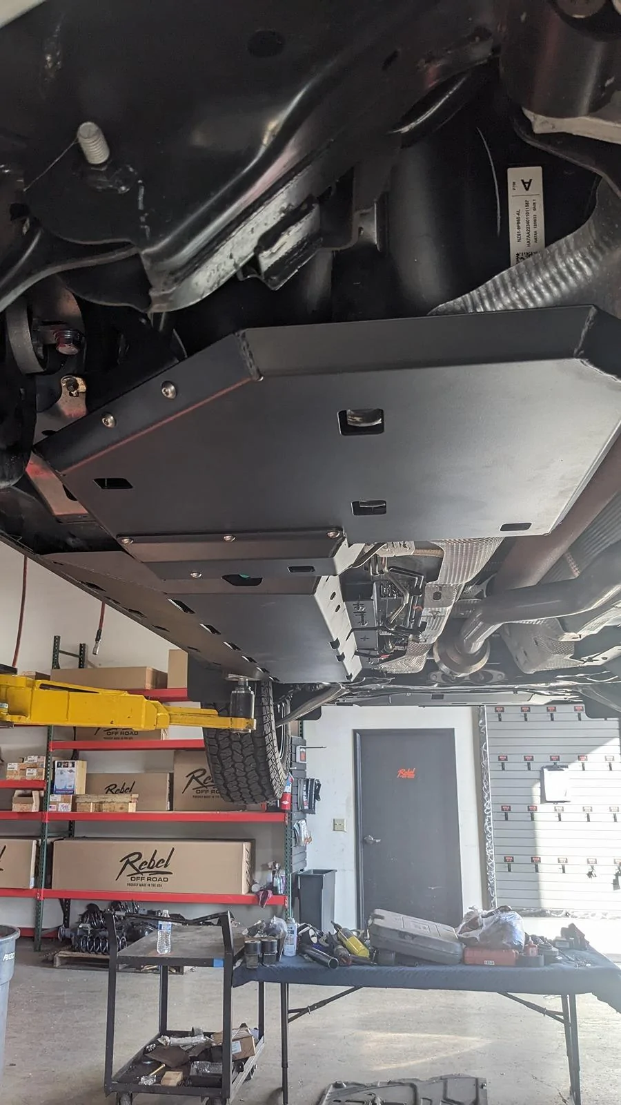

- The pair of floor skid plates installed as described in the video. Yet, the evap plate pictured on the website and part of the description was not included in my kit (or fell out because the packaging was damaged).
- Installing the gas tank skid plate required some cuts and bending of the aluminum heat shield.

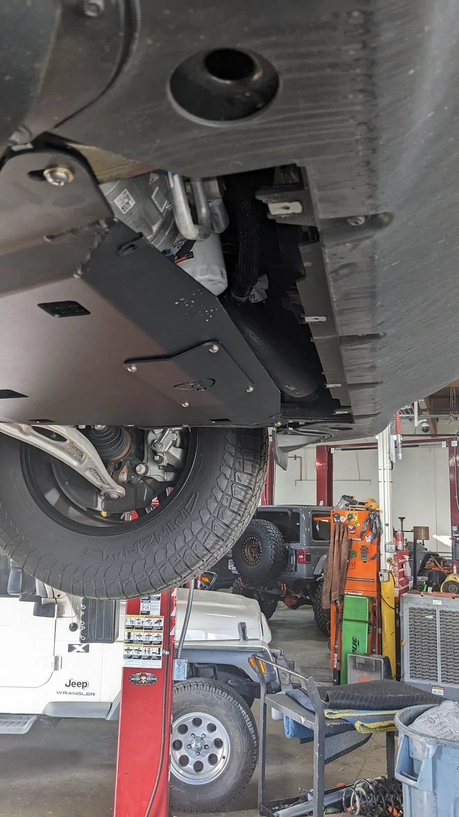

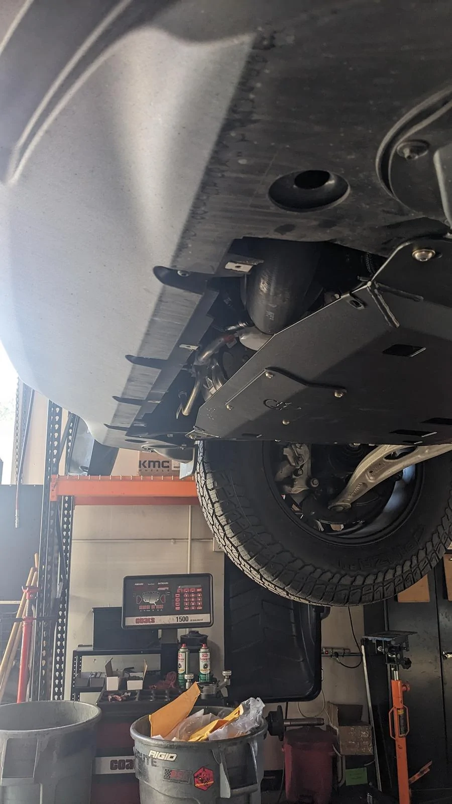

- The front engine skid plate appears to be the wrong part. Maybe it was meant for the FX4? It doesn't mount to the bottom of the front bumper/spoiler (see the pictures below).
