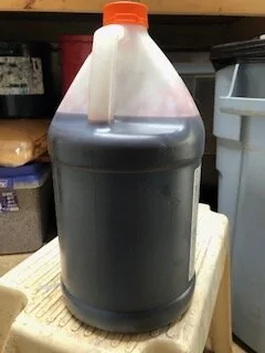

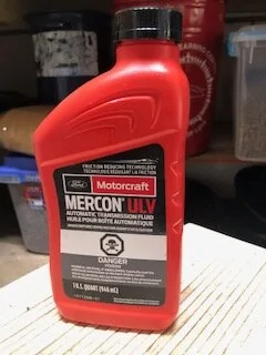

I drained about 3 quarts of fluid (shown in the 1 gallon jug photo) and refilled with 4 quarts before it started to run out the fill plug hole. I believe it was slightly underfilled at the factory. Probably not enought to damage anything but still a little underfilled.
The fluid was darker than I thought it would be, but didn't smell burnt or unusual. There were a few metallic flecks in the pan, but I expected that.
