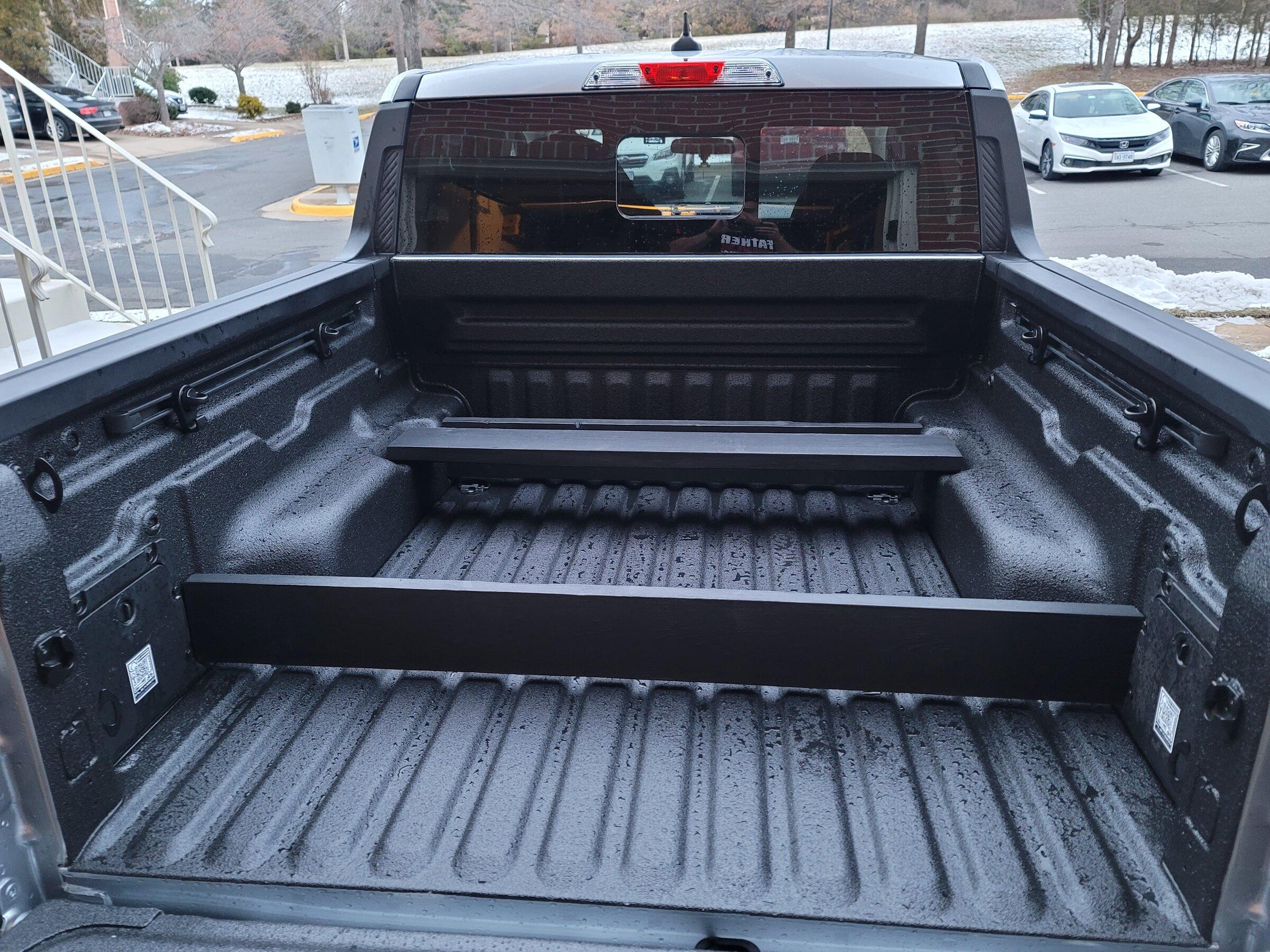

Got my Maverick 2 weeks ago and immediately wanted to make it my own. I noticed that the Lariat did not have the bed rails so I scan the QR code and immediately start looking up the parts needed, but they are hard to come by. Also with the bed liner, silver/gold channel strut, I didn't think it would look great
That's what I came across a beat up Tacoma on a lot and saw the bed rails! I immediately thought that I could easily cut them down to size, drill a couple holes and voila!
Just wanted to share this on here for any searching for bed rails. Tacoma 05-19 bed rails work great, they just need to be trimmed and 2 of the 3 holes drilled out to line up. The purest might not like Toyota parts on a Ford, but there was also an entire thread about buying a Kia rear view auto dimming mirror to be installed on Mavericks soooooo...
I'll have some pics on here tomorrow!
