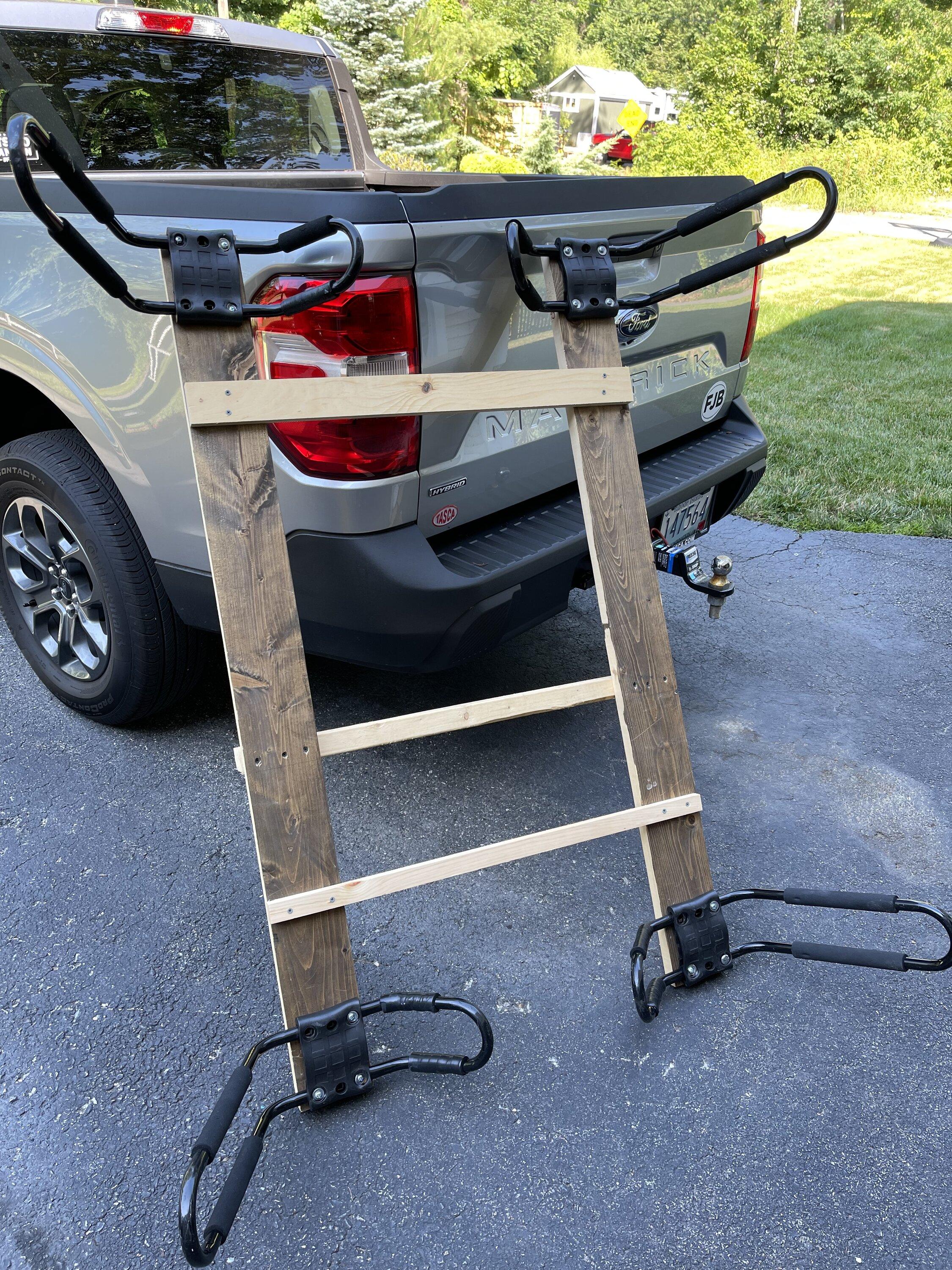

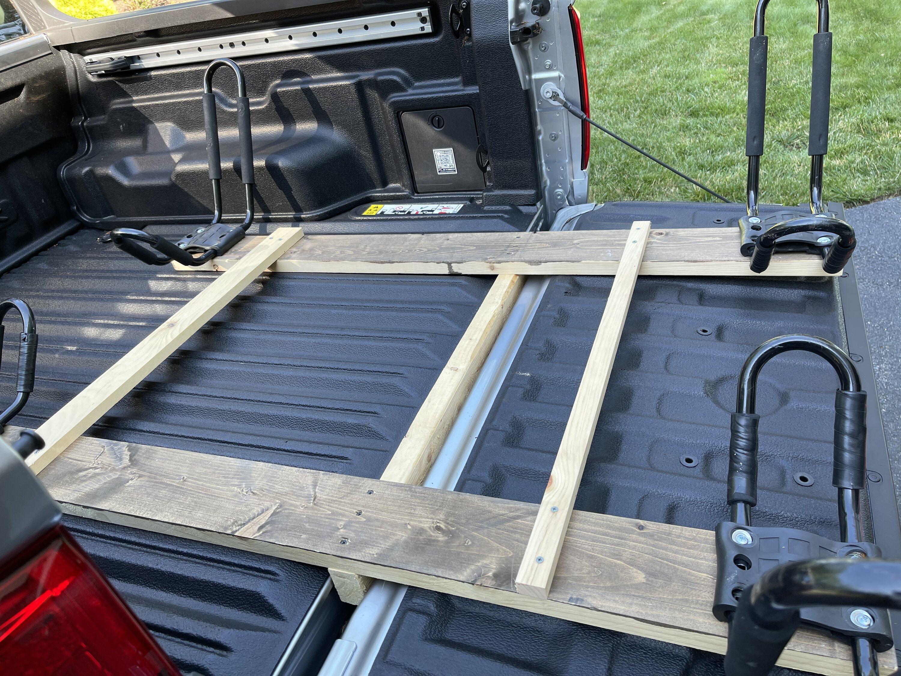

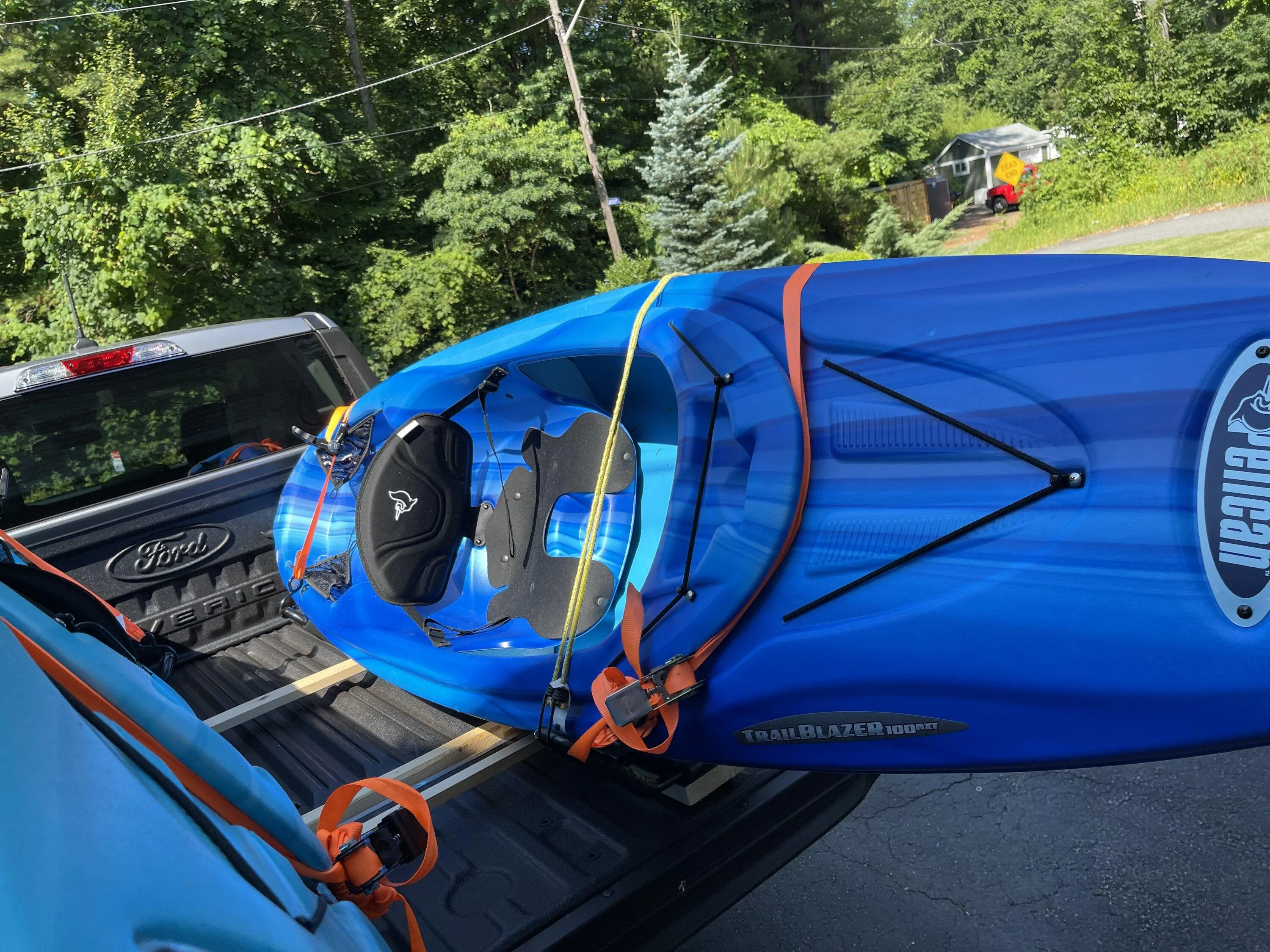

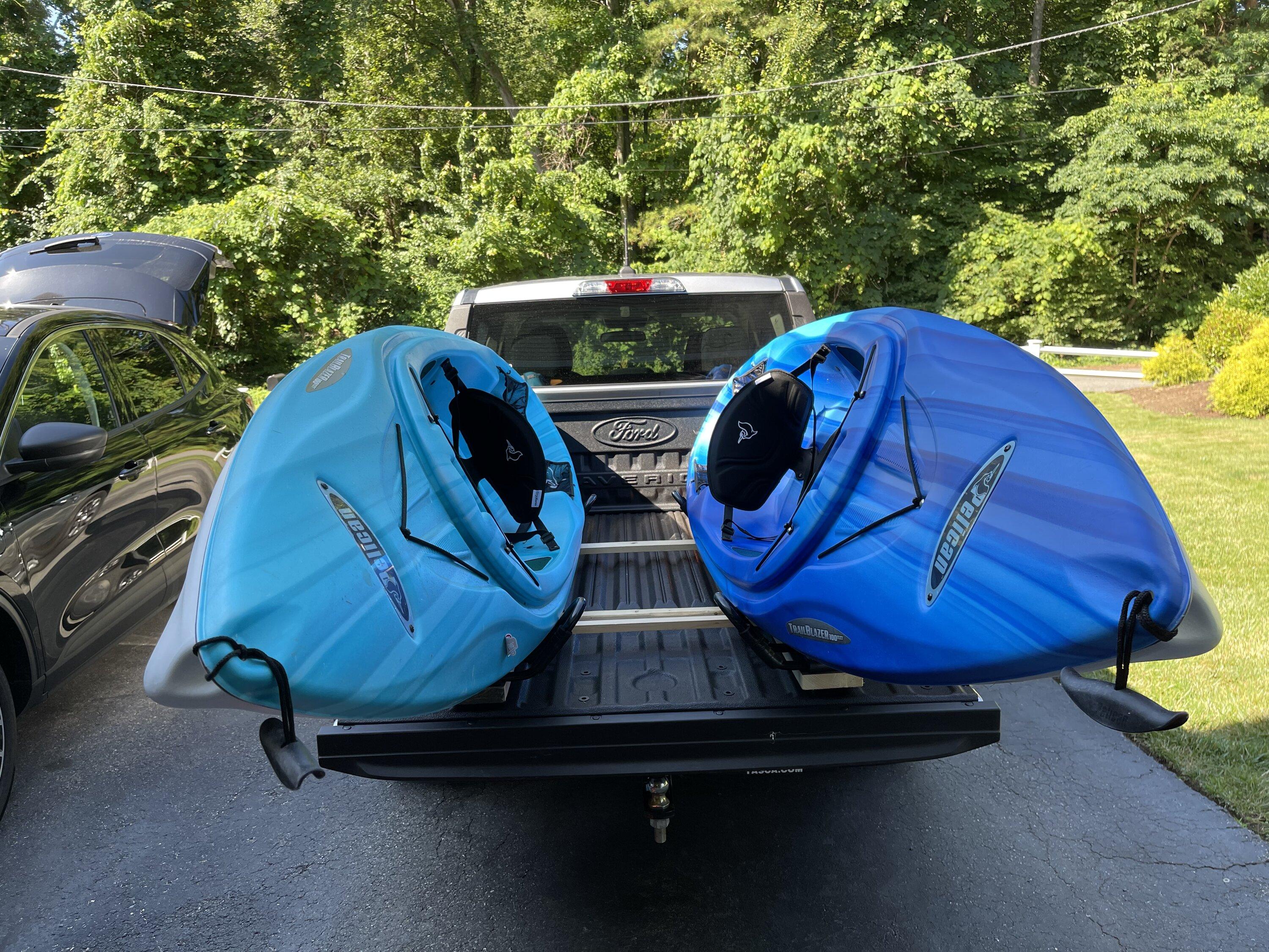

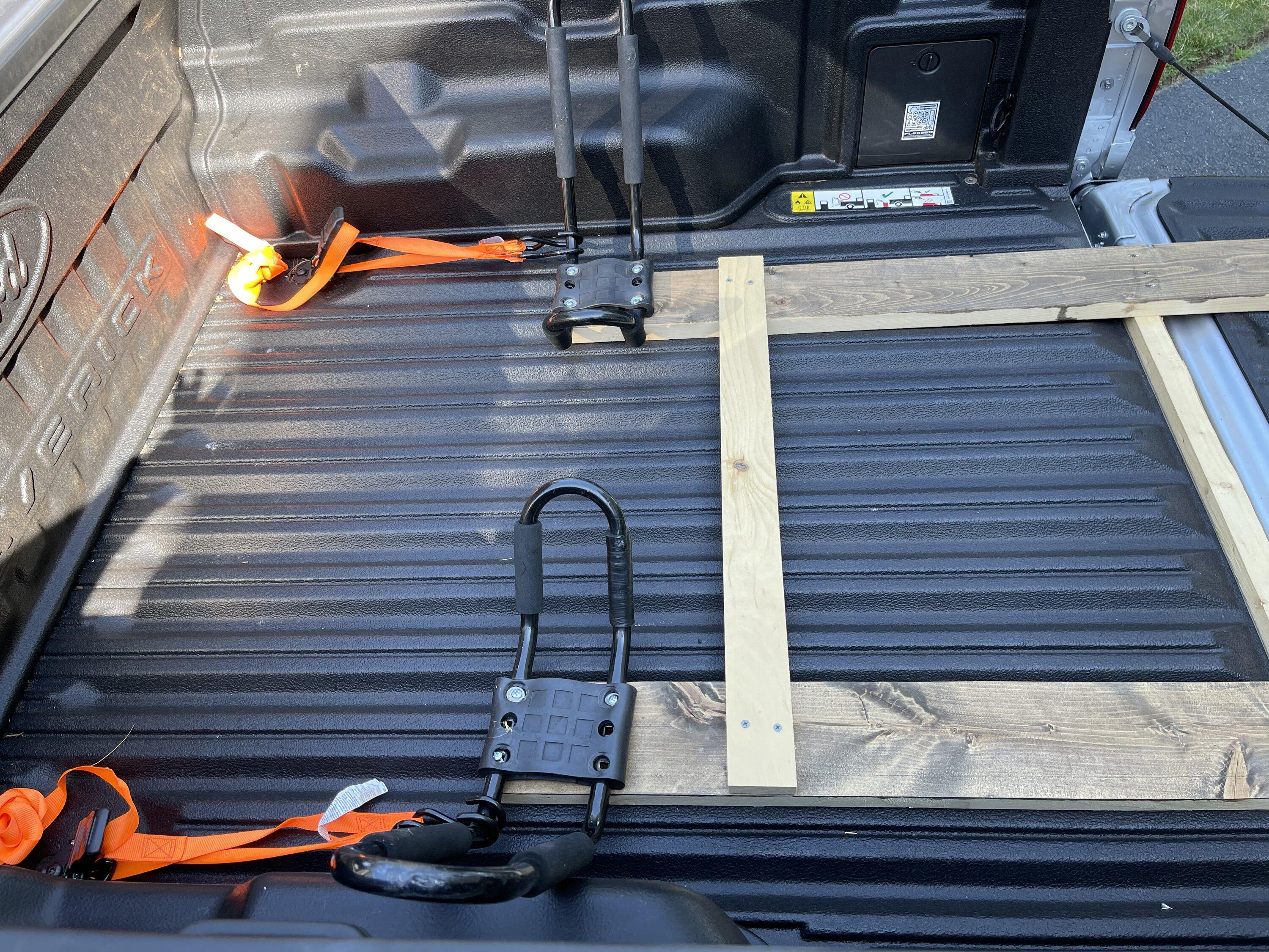

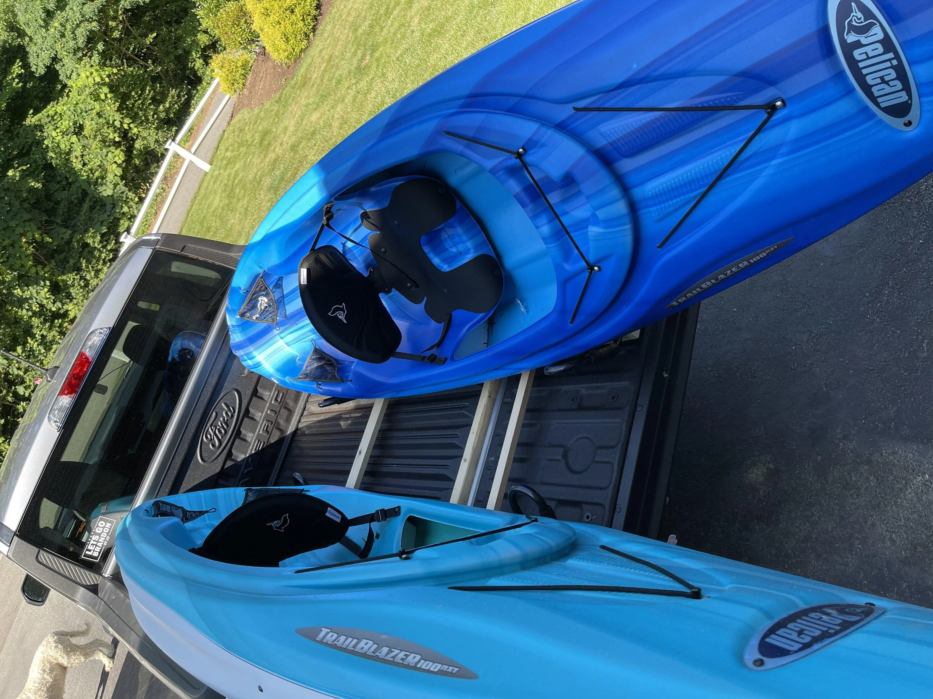

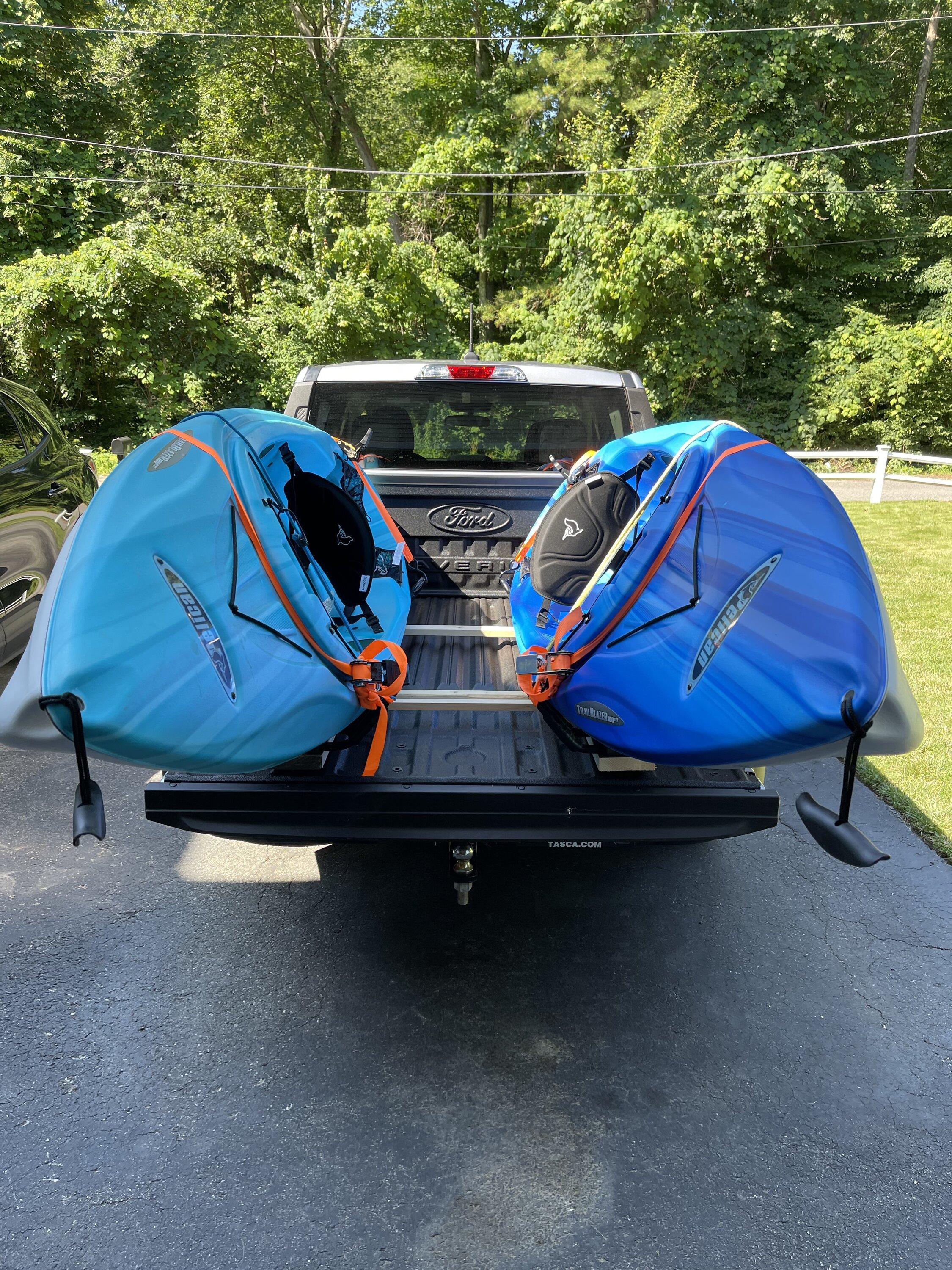

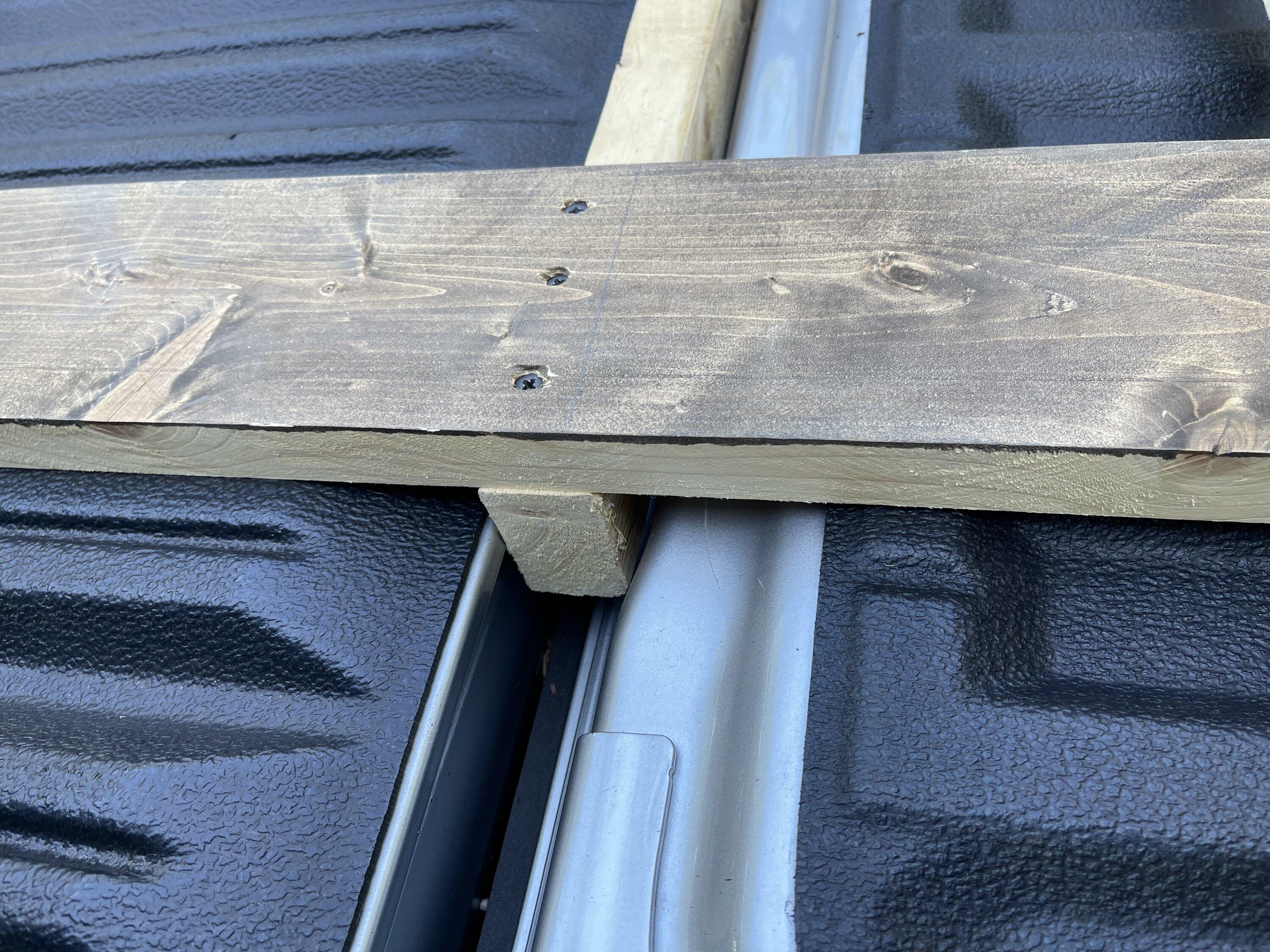

I wanted to share my solution for transporting 2 10’ kayaks in my Maverick. I’ve seen some of the mounts and racks available to buy, but this cost about $50 in parts and the rest was scrap wood from my garage. Works excellent and preserves visibility through the rear window. It’s very sturdy and when tied down, the kayaks don’t move at all.
